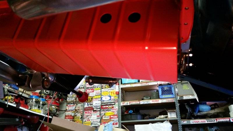

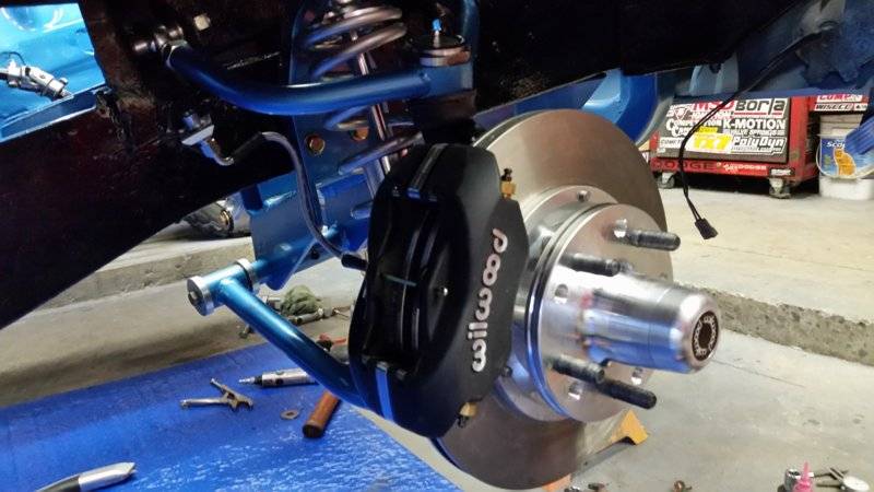

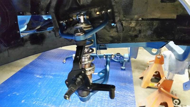

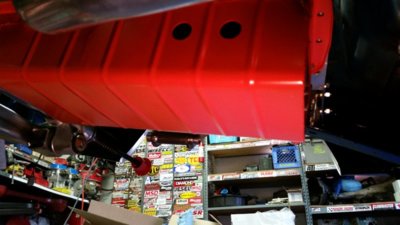

I have the RMS kit on the front of my Challenger. Huge weight savings, best thing about it I was able to run a flat bottom 10 qt Hemi dragster pan and plenty of big tube header clearance now also.
