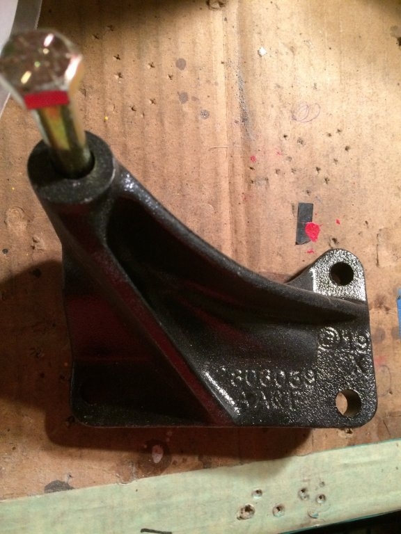

This type might work for you. I can take a picture of it on the engine if it helps. IIRC it's for A/C.
