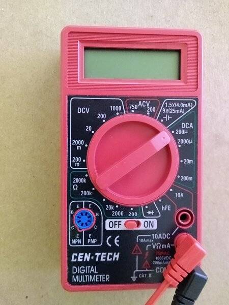

Thanks Bob. The alternator is a round back with external regulator. I removed the negative cable from the battery post and measured the (reverse) current from the negative battery post to the disconnected cable with the alternator battery terminal connected and got 2.2 on the 200µ DCA scale of meter (see picture at #1 above). When I disconnect the alternator wire to the battery and measured the amps, I get 0.0 on the same scale. I assume this 2.2 reading means it's 2.2µ amps (or would it be 2.2 amps) when using the 200µ scale? Do you think I am measuring this right? It seems the only drain is from the alternator but 2.2µ amps is not much. Is this what you're talking about doing?

YES.....Since your meter is on the 200 uA scale and you are reading 2.2 uA that is the current loss back thru the alternator. Over time this small loss will drain the battery enough to cause starting difficulties. The battery has several bench mark measuring points. Almost everyone quotes the CA (cranking amps) or CCA (cold cranking amps - amps produced at a specified temperature...important for cold weather operation) as the most important factor BUT...the overlooked factor is Amp Hour rating....which is how much energy can be supplied (usually 20 amps) for a specified number of time (minutes or hours), without charging, b4 the terminal voltage drops to less than ~ 10.5 volts. The larger the AMP HOUR rating is the reserve capacity, and is determined by the number of plates per cell and the surface area of the plates. The chemistry of the battery (lead, lead dioxide and sulfuric acid) results in 2.1 volts per cell, but the number plates and their area determine the CA, CCA, and AMP HOUR rating of the battery.

Ed, I think you are reading the meter correctly.
0.0000022 amps is close to nothing.
@Ranger16 might be correct, maybe as simple as a bad battery.
A .7 Volt drop over 4 days from that low of leakage current doesn't jive.
