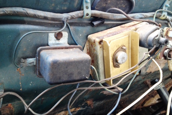

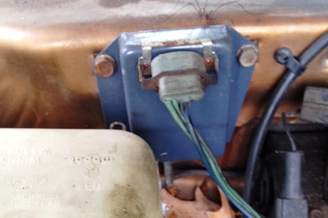

All good information. Your issue sounds like either an alternator with some bad diodes in it, or the Voltage Regulator is not working. Make certain your voltage regulator is well grounded. FYI, charging systems do NOT have/use a ballast resistor. Also, there are basically two styles of alternators:
Single Field- one 'bolt on' battery connection and one 'plug in' connection (to the voltage regulator) and uses a Voltage regulator that looks like this (square black box):
Dual Field - also has one 'bolt on' connection for battery but has two 'plug in' connections to the voltage regulator (the regulator will make one of these 12ish volts and the other will be 'regulated' by the voltage regulator.
Voltage regulator looks like this:
