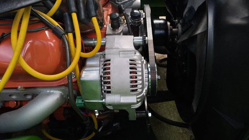

I need to replace my alternator. It’s on a 1969 charger, 383, AC car (double groove pulley). Any recommendations on a good replacement?

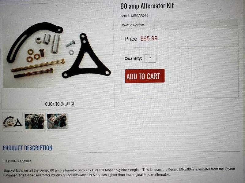

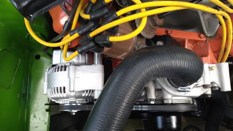

I would go HOWEVER (as usually advice) with an alt upgrade though, getting an unit able to provide more juice.
