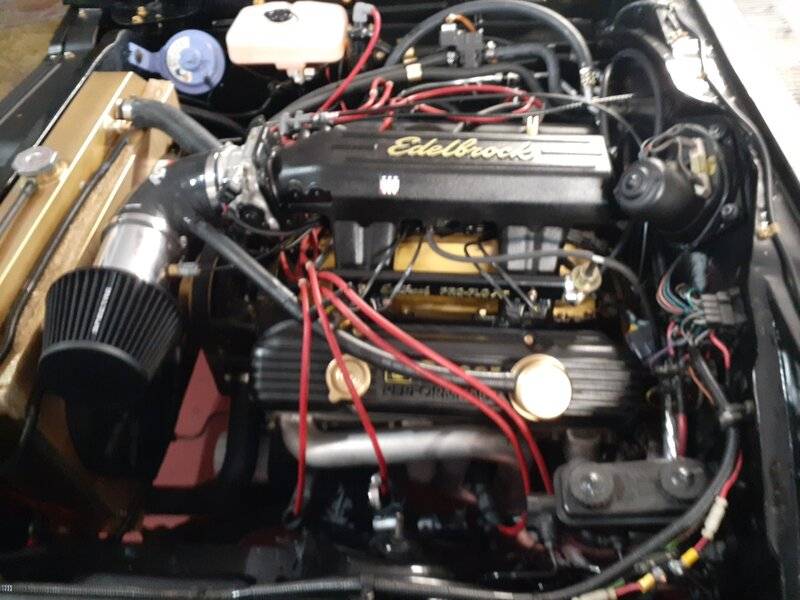

i used a #2 gage cable from battery to alt with a 150 circuit beaker. i used 2 fuse links 1 for each fan to alt. then i have a 0 gage cable from battery to starter then a 10 gage from starter to relay all acc power comes from starter relay with fuse links . fuel inj is powered from battery and ignition switch for key on power all other wiring is ran like the factory.
