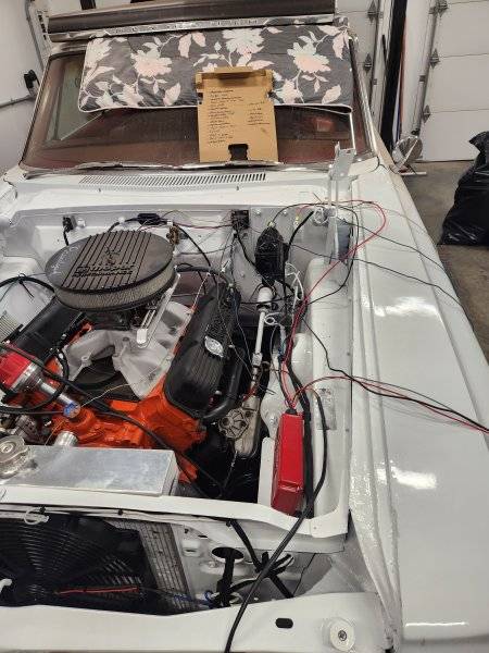

Hey guys,
I've searched this a bit and I didn't come up with anything so apologies if this has been asked and answered.
I have a 64 plymouth that I am relocating the battery to the trunk... i know, hang in there for a second.
I'm trying to come up with a simple solution to the car proceeding to run after the battery disconnect is shut off.

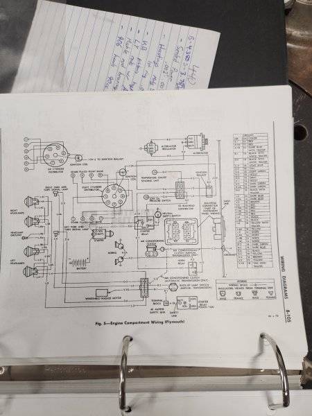

The battery charge wire from the alternator goes through the bulk head and into the dash wiring, what appears to supply the interior/dash with power.
My question is can I put the pre-existing wire that would go on the alternator onto a ign power post and run a new charge wire to my remote battery before the shut off to rectify that issue.
Only thing I can think is the factory ammeter in the cluster would not work which I am perfectly fine with.
I was planning on trying it but thought I'd use you guys vast knowledge first.
Thank you

Why not just run the big wire to the batt and call it a day? No real need for the cut off?
