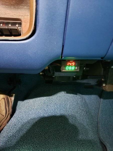

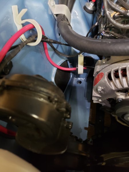

71chargerammetersensor.jpg'71chargervoltammeter.jpg I've been using my Bayite BYT-VAM-036 digital volt/hall effect ammeter for 1 year now and I have been able to get a lot of good information from it. Accuracy is +/- 1% and indicates direction of current flow so could be used in place of /in addition to factory ammeter. Nice feature is the hall effect sensor which enables you to easily place the sensor over any wire to monitor current without any splicing. Inexpensive ($25.00) unfortunately made in China. If I could locate a US made version I would buy it. Got this from E Bay. Make sure your meter includes the 6.5' sensor extension. Mine is shown at alternator output cable.
