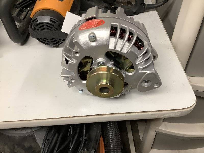

New 100 amp alternator from quality power, new voltage regulator, complete new wiring harness, the problem is that in drive, 700 rpm, the needle is showing discharge, voltage is 11.2 volts, bring up the rpm to 1000, 13.9 v and needle is in the middle but in park or neutral the rpm is 1200 rpm way to high in my opinion. Is there something I can do to increase the performance of my charging system at idle? Before the restoration the needle was rock steady, charging right after starting then settled down to the center and you could put in drive, fan on, brake lights on etc. and still steady in the center.
Try putting your old voltage regulator back on and see what happens. If it was controlling voltage better with lower amp alternator, it is likely a better piece than your new one. Have you upgraded your charging system wires to 8 ga. with upgrade of your alternator to likely double of stock output?
your voltage readings are pretty precise. Not a stock gauge I assume? What gauge are you using?
I had something similar happen when I installed a 70A Powermaster alternator. Two things - check your pulley belt tension. Second thing is even my 70A alternator is higher than stock output and didn't work with my original voltage regulator. I know you installed a new voltage regulator, BUT I didn't discover mine was a problem until I fried my temp gauge. I switched to a voltage regulator with adjustable potentiometer on the back (make sure proper grounding of VR case to firewall by sanding off paint near bolt hole) and checked battery voltage at idle and adjusted the VR until it was 13.8-14.1 at idle and now all is good. Your voltages are a little low instead of high, but possibly your system could benefit from this adjustable style as well.

Didn’t you read the first part of my post where I said I was an idiot! Maybe I forgot to mention it! I tossed my regulator, for reasons unknown, lesson learned! Great thought though, thanks!

Oh, and yes, I might need to increase the wire size, good point.

Yeah, that’s the first thing I did and I thought I was on to something, fresh paint, new regulator,,,,, possibly a not so good ground, unfortunately that didn’t cure it, but hey, great minds think alike!
I will however order one of those adjustable regulators just to rule it out, thanks!

He is doubling the alt output CAPACITY but not necessarily the output. If the car load requirement sucks 35 or 45 amps to work, you can install a 500 amps alt but the car will still require the same 35 or 45 amps to work... So the alt will provide JUST that while voltage is also stable.
the bigger alt capacity on this case helps on get the best output posible at the slower rpms and save the batt from being discharged when alt is not capable. So this would/should guarantee a batt always charged what doesn’t mean CHARGING status…and the ammeter on zero reading, except for some minutes after crank the engine where should be recharging the load lost when sourcing the starter motor.
sure this happens while everything is in order.
I’m wondering about a bad diode on alt?

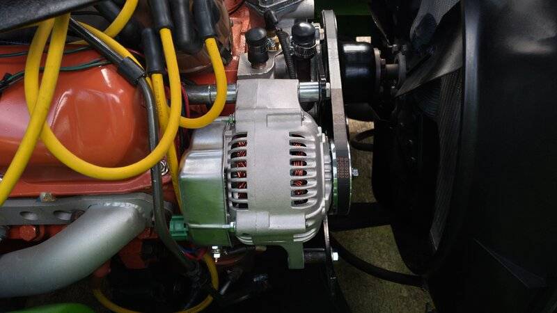

These are all the reasons that I went with a Denso alternator on my 440. Internally regulated, and
charges at idle. The original design wasn't sufficient to charge at idle.
charges at idle. The original design wasn't sufficient to charge at idle. View attachment 1354601
No light dimming, discharging at idle?
What kind of mods were required. Where did you get it? Thanks for your input!
I went through some wasted time and money trying to smooth out the original system and the so-called new parts are really iffy at best. I put on a power master 100 amp internal regulated alternator and substantially upgraded the charging wire and eliminated the bulk head connector as well.
So far everything works well and voltage doesn’t drop below about 14.2 volts at idle with everything turned on including the blower on hi. Just my opinion and experience and that’s all.
