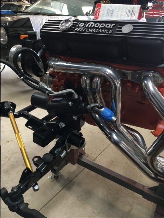

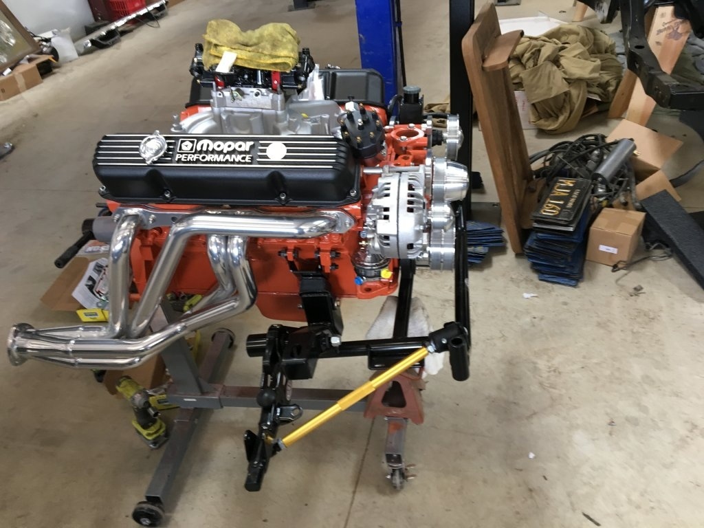

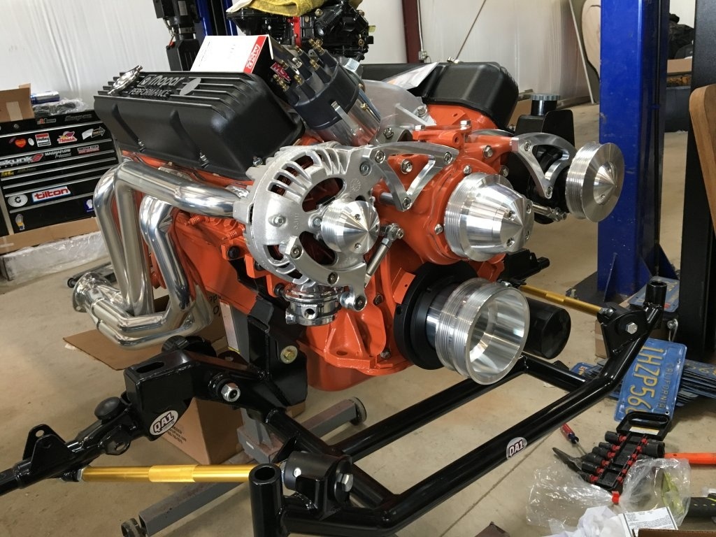

QA1 tubular k-frame
with stock motor & steering & sway bar mounts
appr. 36#'s-38#'s with hardware
QA1 LCA's with sway bar tabs welded on are appr. are 19#'s pair
8.5#'s each
SPC UCA's dbbl adj. on the car are appr. 14#'s pair
7#'s each
QA1 dynamic adj. strut rods are 5#'s pair
2.5#'s each
appr. 76#'s total
