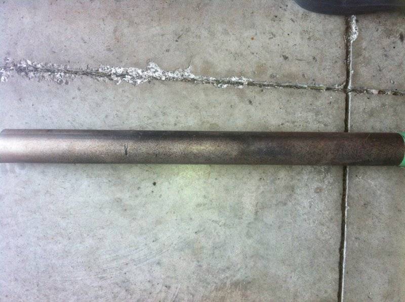

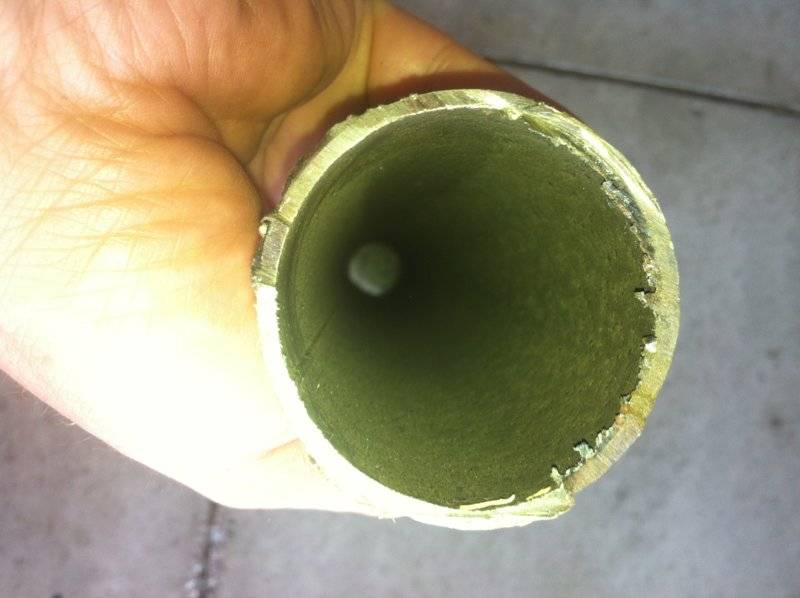

here is a piece of aluminized exhaust that I cut out to install headers to my car this year, this exhaust system is over 12 years old and the car gets driven alot every year. Check out how thicK this pipe is and it is heavy to
View attachment 634575 View attachment 634576
