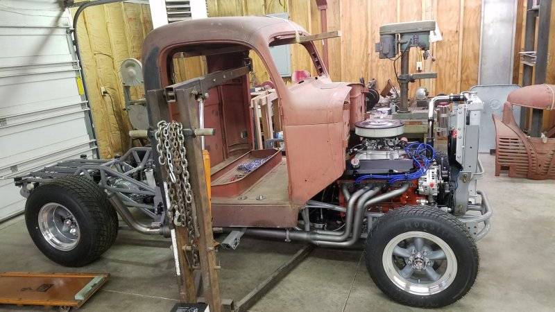

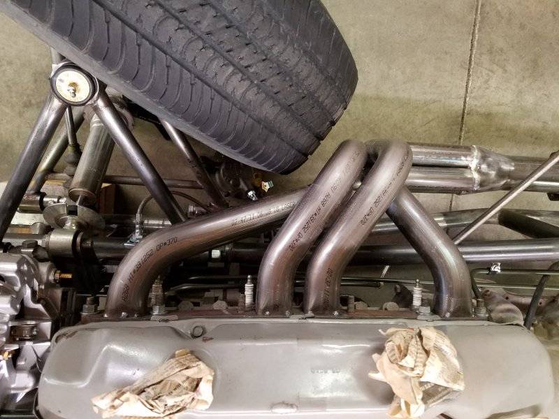

Why not a custom set?
Low cost and competitive quality.
These cost me $320.00.
Have a set on a Jeep CJ from the
same builder installed more than
20 years ago. Zero issues

Headers on a Jeep is quite the project
given the space constraints are
limited to inside the frame and run
to the rear.
The set in the pics is on a 440 in a
1940 Plymouth truck. (custom tube
chassis).
PM me if you'd like a reputable source
for a custom built quality header.
Guaranteed he's run across B Body
builds before.

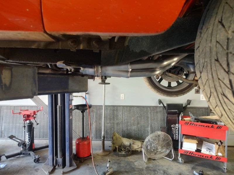

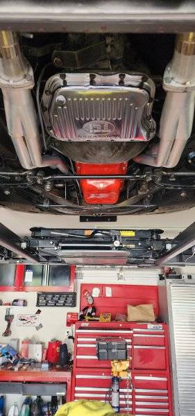

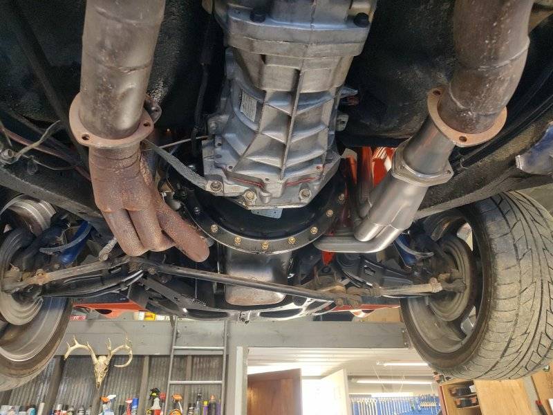

Figured I'd share a few pictures.
Doug's headers are pretty much identical to Hooker Super Comps for ground clearance, the collectors being significantly shorter however might be a huge benefit? The Hookers fit great but had some really annoying bends that trapped bolts, made certain plugs hard to access and made overall installation more difficult, I'm definitely liking the Doug's. Also, it seems like Hooker put more effort into making the tubes equal in length, not sure how much difference it makes?

I was in the same boat about my previous Direct Connection and Hedmans hanging too low (never wore a pair out before beating holes in them). But my ceramic Doug's have been nothing but wonderful at a more reasonable price than the TTIs I dreamt about for so long. Summit has great 360° views to compare all the headers you mention - that's how I made my determination to buy the Doug's. Even better, they installed REAL easily in my 71 Satellite. (747Mopar above has good pictures to reference!)
