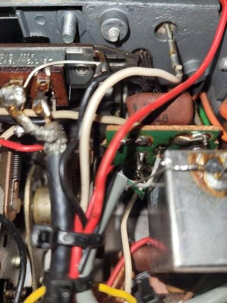

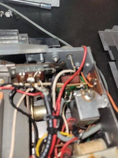

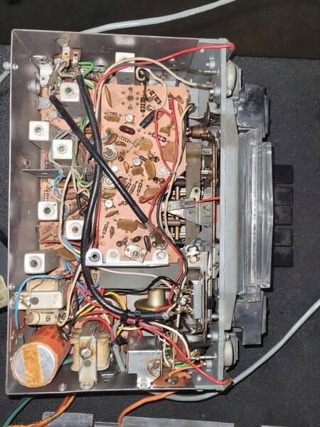

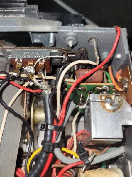

Well I hooked up an AM radio that I had and even in the garage it was pulling in stations pretty strongly. So there's more to the issue than that. Next I pulled the top off and to my untrained eye, lol it looks original and old. But overall pretty clean and in good shape. The only thing apparent is where someone (may have been wards but not sure) soldered the mp3 wire into some existing stuff in there
That MP3 setup looks like what Wards did for my radio. That was typical for them to restore as factory and add the MP3. Hope your able to figure out the issue.

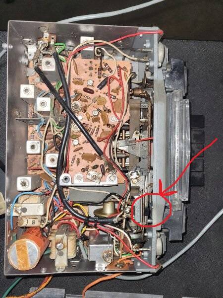

An update on my radio issue. I found the paperwork from wards with what he did to it. I would really like to use this radio. It appears that it worked 11 years ago when it was returned from wards. Should I send it out again to somebody to fix ? Or are there user serviceable things that can be done by me ?

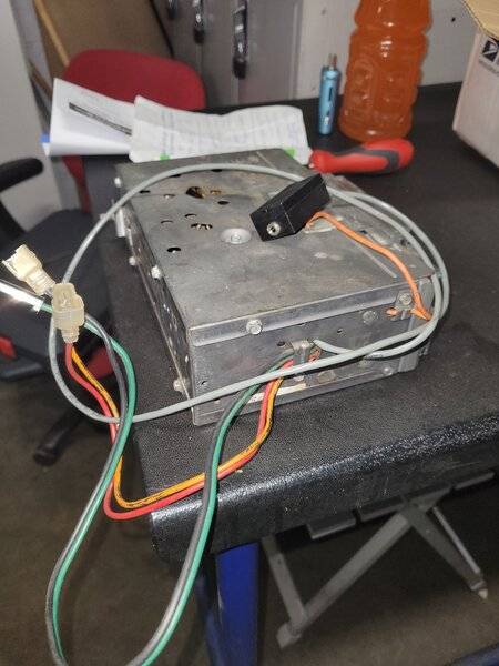

Ps I looked at back of radio and it appears as it should with stock wires and colors. Except for the mp3 looking input jack

I will probably do that. I pulled the top off and the mp3 cable is hard wired in everything looks good though it's strange it just doesn't work. I'll screw around a bit with it. it's out of the car but I have a speaker and a battery I'll mess around a bit with it. Maybe sitting for 11 years some stuff corroded or something. The only sound comes out is a popping noise when you work the am/fm switch. But no static or anything. I'll check out that website. Thanks

Well it's been 3 months and I finally had time to mess with my radio. I hooked up speakers and power to it and used an older phone with a headphone jack to plug into the mp3 input coming out the radio, and music plays through the speakers. I also have corresponded with a Mr Gary Tayman in Florida and he no longer repairs radios, he only modernized them now. Has anyone out there had a radio repaired recently? Or can recommend a place that does repairs?
