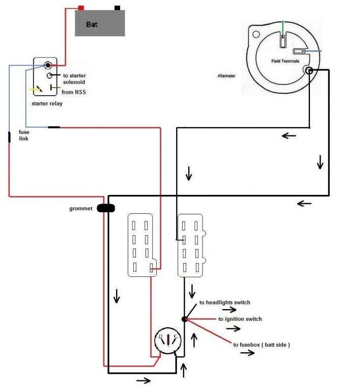

Hope Nacho doesn't mind, but this is one of his diagrams I'm going by...
As you can see, it does not bypass the ammeter.

With an alt able to feed the car demands, the ammeter won't get load going throught because batt will never ( or barelly ) source the main splice located on alt side of ammeter.
The ammeter is related to the load coming and going to/from batt. As far you keep the batt out of the sourcing play, you'll be doing the same with the ammeter.
An alt able to provide around 45-50 amps IDDLING ( 40 amps can be enough too in some cases ) if the car demands for that, will keep you safe everywhere, just needing to save the black side of the wiring at bulkhead ( bypassing bulkhead or going parallel if the existant wire is still nice ). Parallel/bypass on red side of the wiring is an extra in case batt looses load and will need to get recharged by the alt OR an alt failure where the batt will be sourcing everything.
I call it PARALLEL WIRING just because if the stock existant wiring ( 12 gauge ) into harness and bulkhead terminals are still nice you can keep them and won't need a really heavy wire on parallel ( another 12 will be enough )
But if need to remove the stock one because got damaged, the single one going out of the bulkhead with 8 gauge is way enough. Even a 10 single one is enough in some cases. Remember the main splice is STILL on 12 gauge rate because is the stock one. The extra gauging will allow you to recharg battery safer on car when get discharged and even add relays on the line ( never on batt side, must be on alt side ) to some added junction or even using the ammeter stud as junction... I DID! I have 6 relays attached on ammeter stud and everything is nice. As far of course is correctly attached.
Doesn't matter if you get 80 amps alt or thousand amps alt... that's the max output rate. The important thing here is the alt is able to source the max demand the car will require at the minimun RPMs as posible. If the car requirement is around 40 amps, then try to source that when car is iddling. Remmeber amperes are not pushing it by the alt, but sucked out by the car so you need a source able to give that.
Blower ( AC OR HEATER ), wipers, hazzards are the more demanding devices on car, then of course lights, turning, brakes. Cigar lighter sucks a lot, but thats not a constant source, just for a seconds. Power windows too. Ignition barelly sucks power believe it or not. Some other added aftermarket accesories sucks lots of power like cooling fa. Gas pump could suck some load too.
My test for a nice alt power is car iddling, with AC turned on ( mid speed at least ), geared, brakes pressed, lights on ( low beams ) and wipers on ( low or mid speed ). If the alt is able to source that and ammeter keeps centered, you are on a good rate coming out from. If you increase wiper speed and AC blower and still get a centered reading under that test, you are BETTER, but, your barelly are geared and brakes pressed. I'm trying to give some extreme test.

I see, a 2nd that doesn't go threw the bulkhead but does go threw the ammeter.
Yes! No need to bypass ammeter if you get an alt able to source all what the car needs at iddle

That's right. I'm just posting making it on that way, is still safe and will keep the accurate and correct reading on ammeter... AS FAR the alt is able to source the car needs. The moment you begin to get the car sourced from batt side for long time or high peaks, then the ammeter becomes on the weak spot of the charging system, because when giving gas, the reading will be high also on the opposite side to recharge the batt. Those readings are the ones we have to save to keep safe the system

Yes, per Nacho's diagram, two wires through the bulkhead. Don't see a problem there, if it helps. Yeah, on the fuses, too. Just want to decide where I'd mount 'em. If it works, sure not going to look the other way.

He is runing a wire straight between alt post and starter relay and reach the batt... that virtually bypass the ammeter, linking all the system on a BIG splice, sourcing all the system from both sides the same without a real direction coming or going the load to be sensed by the ammeter

Actually If you check the tipical solution used with a wire between alt post and starter relay ( what you did ) and check the location of the main splice inside the cab, the bulkhead is not out of the game yet, because is still being feeded from outside through the bulkhead. THE ONLY DIFFERENCE is the load being shared between two terminals ( equalized ) and not just one getting more load than the other. Or actually just saving the bulkhead terminals from the load when battery is being recharged.
