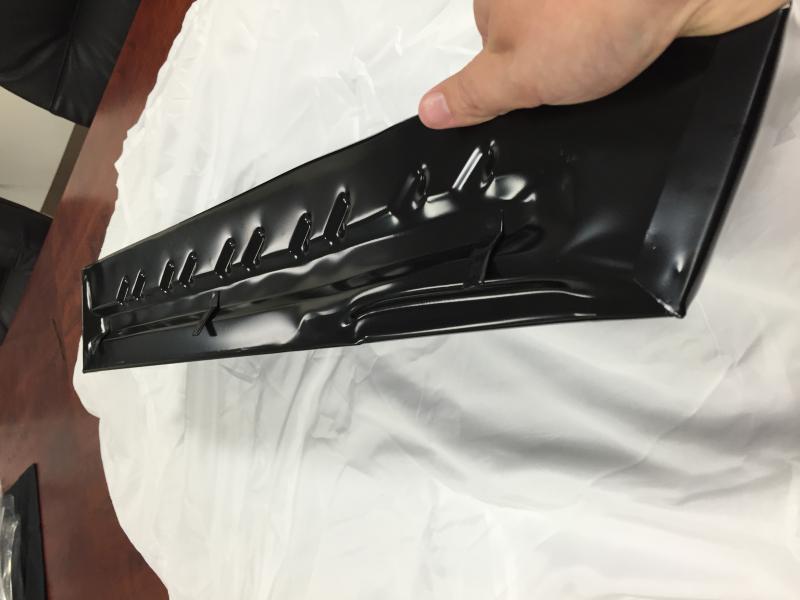

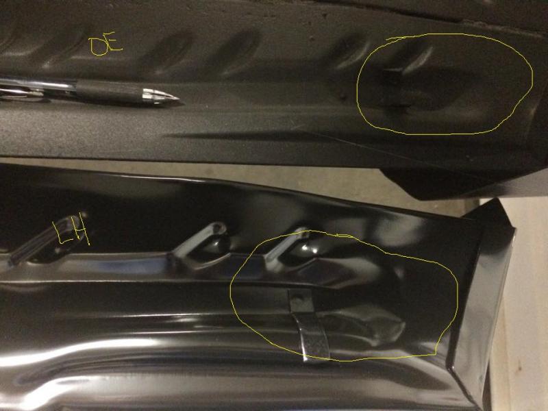

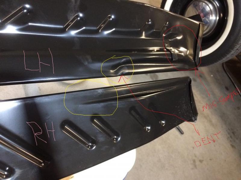

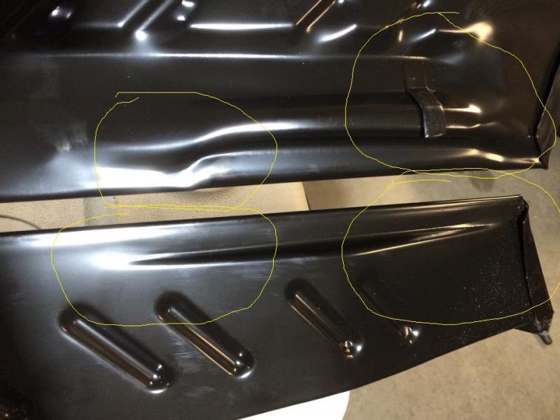

In preparation for trunk floor work I purchased the LH and RH trunk drop offs from AMD. The passenger side is close enough, but the drivers side is down right awful.
I have been talking to a gentleman at AMD via email and sent him a few pics, and I was surprised when he said he couldn't see what I was seeing. He did send me a picture of another one from their warehouse and it appears that the warehouse pieces are the same aweful stamping as the one I got. So that rules out accidental damage.
I'm at the point where I want to return the LH drop off and maybe try a goodmark piece...Suggestions?\
The two AMD pieces... (RH is good, LH not so much)
Picture sent to me from AMD, appears to be similar to my bad piece...

There is nothing wrong with the Left trunk floor extension. What you have there is a 1970 panel. The strange shape you see is relief necessary for the 1970 side marker. In 1970, the marker was much larger, mounted lower, and very large on the backside since it now was a lamp. The trunk floor extension was reshaped to clear the large lamp.
Not a quality problem!

Well thats interesting... You may very well be and probably are correct, but I'm still skeptical, why does does one look smashed and the other does not? I checked the part numbers and they are for a 68 (or so the label says)... I've not seen a 70 drop off but I wouldnt imagine it looked that sloppy.
Either way, I appreciate your input, and will keep an eye out for a 70 and take a look!
