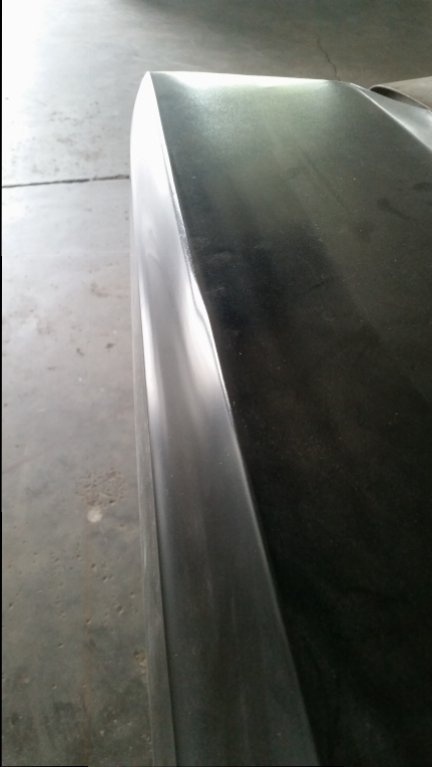

My body guy has done alot of goodmark panels for all the chevys & some fords & said he has never had any panels look as bad as my AMDs..the fitment is ok,he said you have to tweek alot of them to fit but the body lines shift in the middle,curious to blow more money buying another set from AMD or going goodmark,I bought mine @ a year ago & got sick a month after & life became more important,well now im feeling better & got my body man back to working on them,they looked great in the box but when hung you can see alot of places,I cut old sherman half replacements off that looked better than these because i didnt want the seem down the middle now looks like as much work

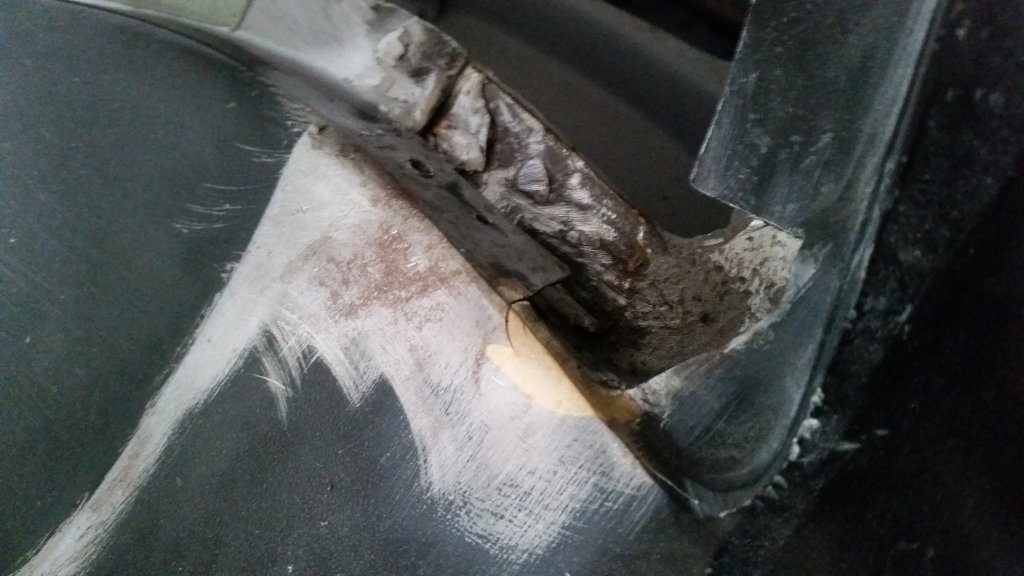

I know its hard to tell in pictures but this top body line,do you think its straight?? looks worse in person,it looked great in the box,alot different on the car..What about what was under my black coating,yes a braze repair,pretty crappy for brand new panels,trying to get Mikes email to see if i can get some kind of credit towards another pair,hard man to get in touch with

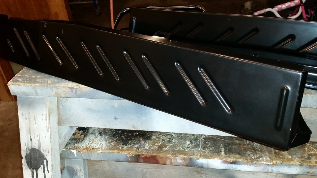

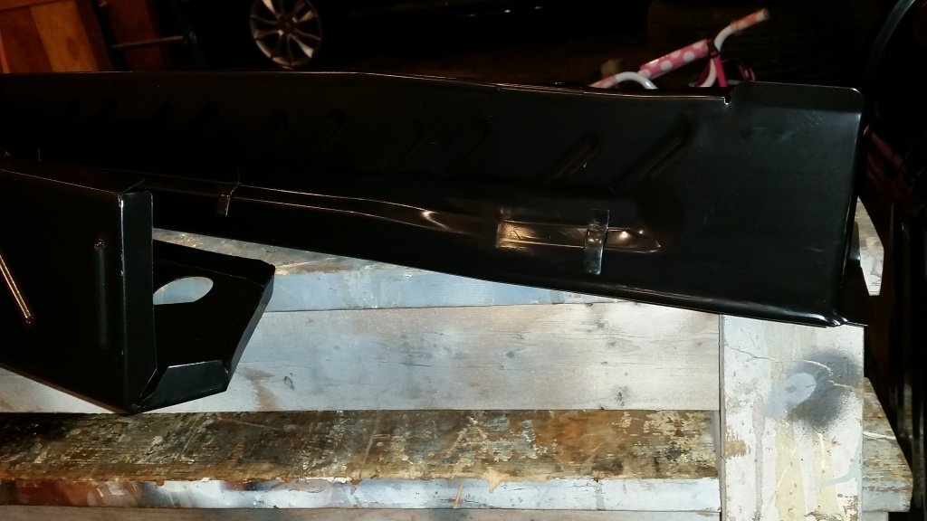

Here are the AMD drop offs I just purchased via Stephan's. They seem to be quite a bit better than what you ended up with. I guess it just goes to show how hit and miss they are on quality. The drivers side does have one small ridge right near where it bends down, and the passenger side seems quite good.
In preparation for trunk floor work I purchased the LH and RH trunk drop offs from AMD. The passenger side is close enough, but the drivers side is down right awful.
I have been talking to a gentleman at AMD via email and sent him a few pics, and I was surprised when he said he couldn't see what I was seeing. He did send me a picture of another one from their warehouse and it appears that the warehouse pieces are the same aweful stamping as the one I got. So that rules out accidental damage.
