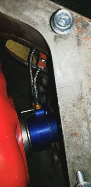

Here's a picture of my TO bearing setup:
Hopefully the side of the blue spacer that had "Ford" on it was the side they machined off...lol!

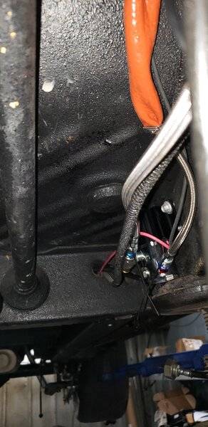

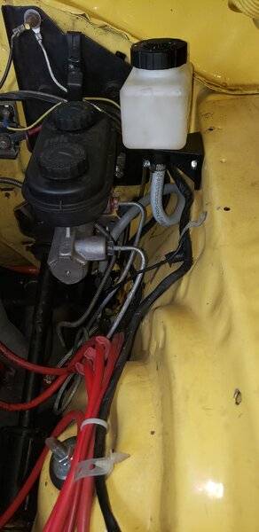

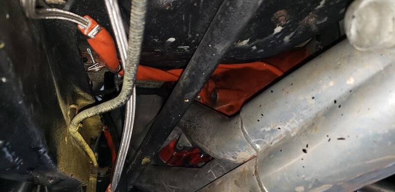

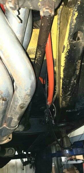

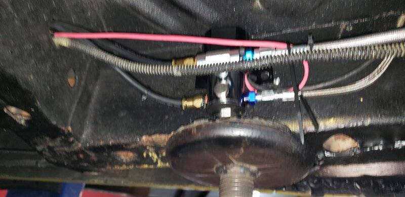

My mechanic did a great job insulating (red-orange silicone composite shielding material) hydraulic fluid braided lines to and from the fluid reservoir, the bearing, and the HitMaster solenoid. This guy is fantastic!
