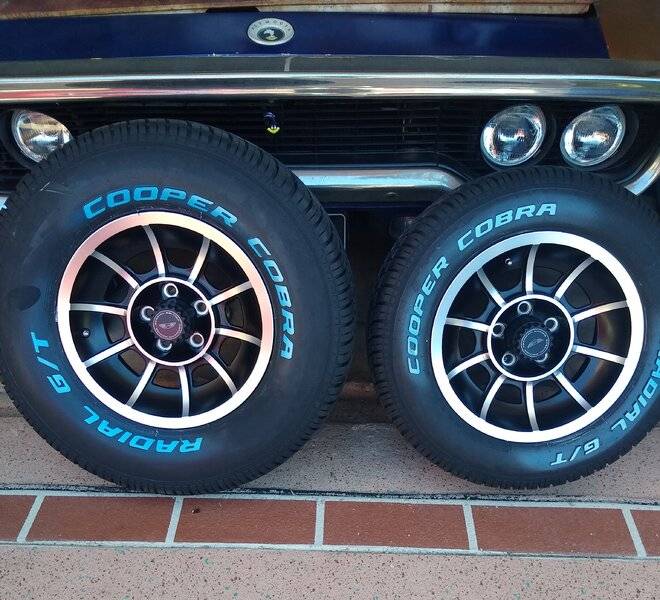

Great info, have any pictures of them on the car?
I found a set in a self service junkyard....They ended up on a '74 Dart I sold but I did put them on the car just to get a look....
I had to take a picture!
