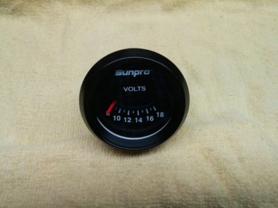

I have seen others do it but what vehicle I don't remember. As i recall, someone found a volt meter that had similar look and font as the stock Mopar Amp gauge, he then disassembled the volt meter and installed it into the dash in the Amp gauge location. If I remember right, it was a SW gauge. I know this isn't super helpful but I know it has been done. Of course the other option is to have someone convert your stock gauge.

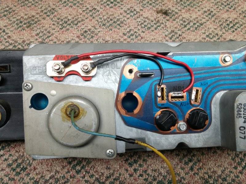

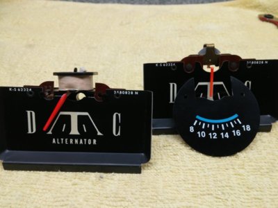

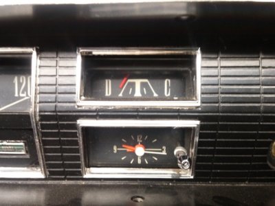

I converted the unit in my 67 Coronet a few years ago. My arm sweeps from the top, I think yours from the bottom? if so, you'll need different model voltmeter. I've been very happy with it.
