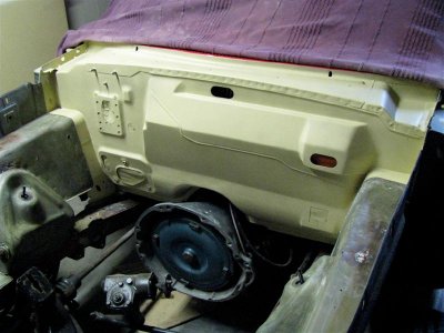

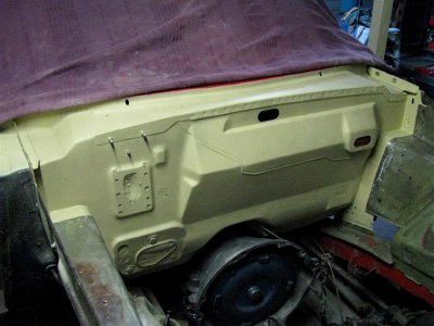

Here's the cowl reconstruction basicly finished, I think I mentioned earlier that there's no hope of finding a donor car around here......so it's been a build from scratch affair, anyway...........
Amazing. Absolutely top notch work, like it was a factory stamped piece. Did you have to hammer that out yourself?
I don't think I'll ever really get used to seeing RHD U.K. cars. With the steering box bolted to the framerail like that what do you do for headers? Fenderwells? Kind of tight down on that side to begin with. I don't think Ma Mopar bothered to shift the engine over to the left side on your cars. Am i correct?
Thanks Sat65, yeah it's all hand formed, there's at least a dozen welds.....you just can't see them all in the photos, some can't be seen at all.
Then there's 20 or so plug welds where it meets the firewall (seam area)
Admittedly, I could've done a nicer job if I could've accessed both sides to do a final hammer up.
One other thing.......watch who your calling a Pommy:icon_axe:
Oh, headers are a nightmare (slip joints everywhere not to mention sparkplug changes.) that's why i'm running ported manifolds.......and your correct,they didn't move the engine over.

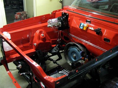

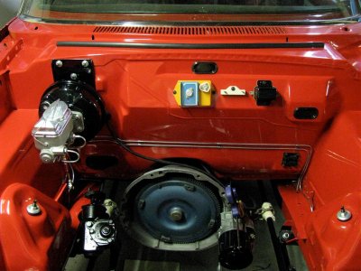

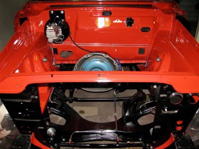

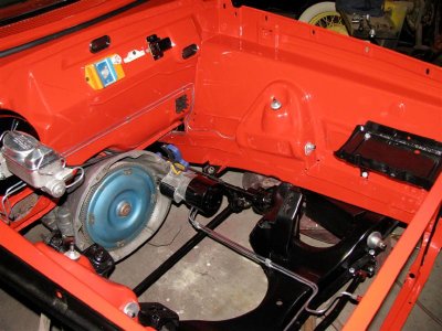

Hi Guys, long time no see (as such) I figured i'd drag this thread outta the depths and post some updated pics. Admittedly the poor old 64 was put on the back burner for quite some time. But before that happened......I got a bit carried away and did a rebuild on both rear quarters ( between the wheel arch and door) Geezuz.......between both rear quarters i removed 15 lbs of dirt and crap (yep I weighed it).....more bad drainage ideas from the Chrysler Corperation....at least they were consistant.

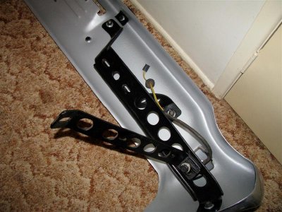

While I was at it I also replumbed the car from front to rear......both brake and fuel lines. Oooops.......nearly forgot, my front bumper is now 7 lbs lighter....yep i got a bit carried away there too . Oh...nearly forgot...I painted the underside of the car while i was at it also. Does anyone see a pattern forming here?
Anyway, here's some pics.......hope you enjoy them.
