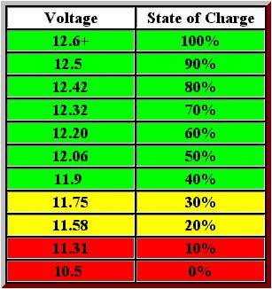

Just tossing out ideas...what 'brand' battery? Some out there, seem to be a real crap shoot. To me, it was funny, when my son called one day, asking about his new Walmart battery (whatever brand it is), asking if it was supposed to 'foam'? HA!I have a brand new battery. Just checked it putting out 12.3 volts.

A fully charged 12 volt battery, should read about 14 volts! Around 12 volts, many times, it needs a boost.
