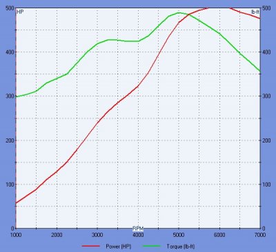

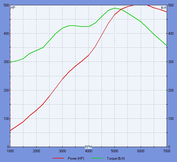

When I plug the info into the DynoSim5 simulator (at sea level, with the 780 cfm carb) it shows about 504 HP @ 6,000 RPM, 485 ft/lbs at 5,000 RPM. With a smaller 670 cfm carb the sim shows a power drop to 479 HP?
The bad news is when running the simulation at 6,000 ft altitude the 504 HP drops to 397 HP (same RPM.)
I will try uploading an image of the sea-level power curve.

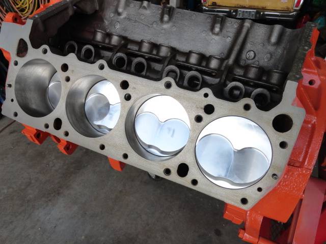

Thanks for running that simulation...amazing how much altitude affects everything! I don't believe the crank was ground but not sure and the rods were custom built by JE pistons is as much as I know right now. Unfortunately, the guy that was building this car passed away about 7 years ago and his dad has been storing the car until he finally sold it. No paperwork was found on the short block so trying to figure out what all has been done. Will likely go have the crank blue printed to be sure. Do you know any good crank folks in the Denver area?
Just curious because the stock stroke is 3.380 and you posted 3.395?
The JE piston #213683 is a 11cc dome big block Mopar piston with a compression height of 1.858, and uses a 0.990" pin, but with stock rods it would sit 0.066" below the deck, even with the 3.395" stroke, so if the rods were about 6.424" long that would bring the piston to zero deck?
On the other hand, the pistons could be custom compression height and the block could have been milled to get zero deck height?

Not exactly sure to be honest....I do know they are custom pistons as there is an order number stamped on them. I called up JE and they had just a limited amount of information since the job was 7 years old...they gave me what specs they had but unfortunately didn't know the volume of the pistons or the rod length. All they knew was the bore, stroke, pin (which is .990) and dome height. I called the machine shop in the springs who I believe put this thing together but they have no records nor remember the motor at all. It sure is a good looking motor though! Lol Here is a pic....
