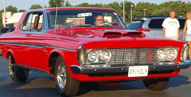

I was wondering what intakes I could use with the 440 RB block and Indy EZ heads on my 63. I am using the Indy dual plane intake and this 2" air cleaner and it fit under my flat hood. And with my Max Wedge scoop it dips down in the center and is only about 1/4 to 1/2" off the hood. Ron
You can see even with my scoop it not far off the hood in the center. So if your using a low block you will have even more room then me. Ron
