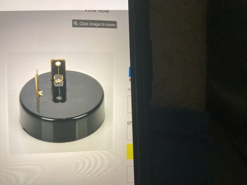

Yes, but probably your wire plug won’t allow you to do that due to the shape of the plug.

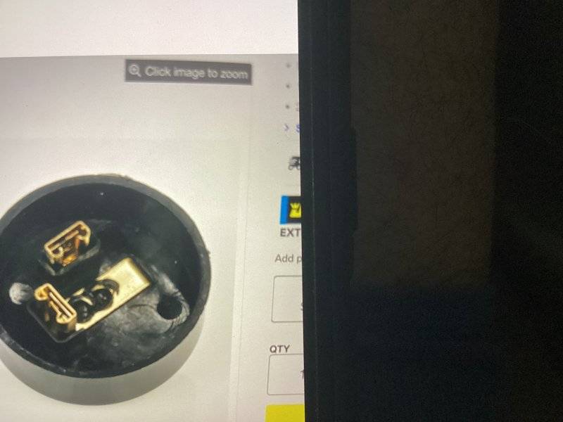

That’s why the flasher I included in the picture of my post allows you to put the cap on the flasher to change polarity.
The cap has internal wiring.
Research that flasher and find a picture of the underside of the cap.

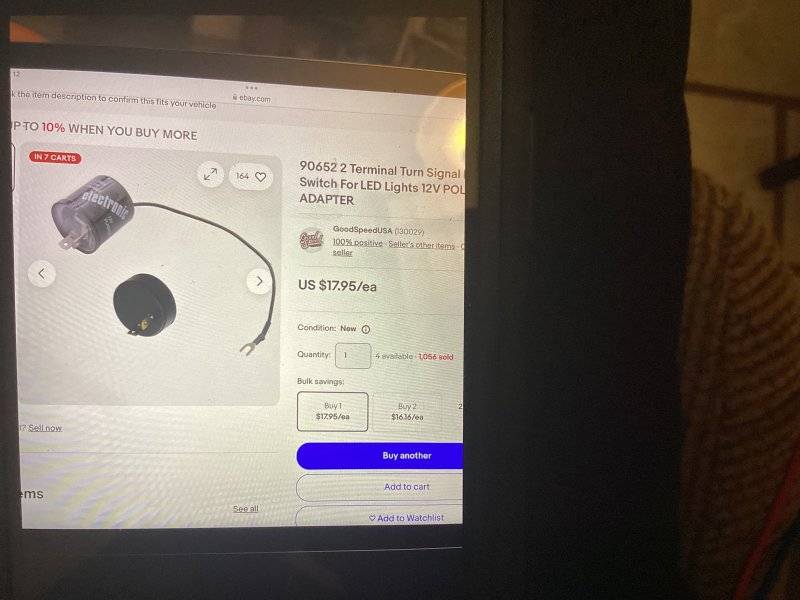

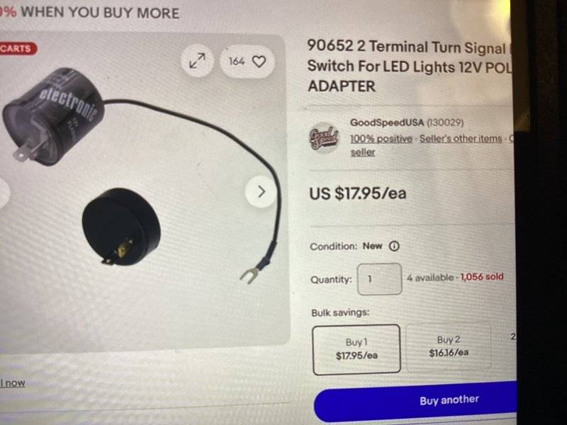

The shop is also getting frustrated with these, and based on what @BDnFL said it may be a PITA, so I want to make it easy on them, or do it myself. I would prefer to buy the caps. Anybody have a link for the correct reverse polarity cap for the flasher I showed above?
I bought mine off eBay.
If you google the model number in the picture many choices pop up. Flasher module 90652.
