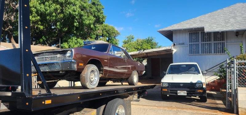

Interesting paint code is T5 bronze and car is bronze but under the hood id dark blue.

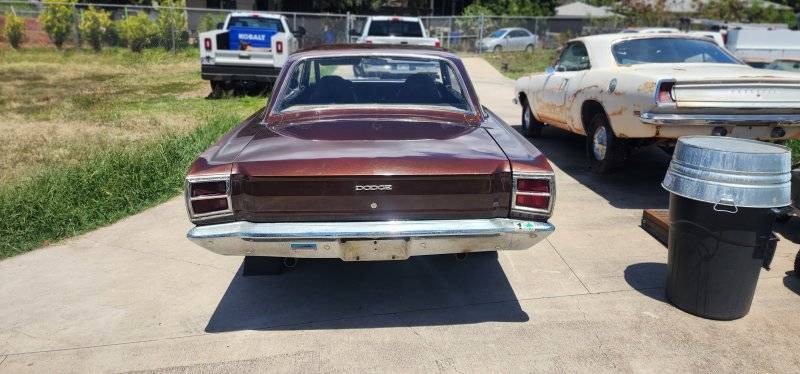

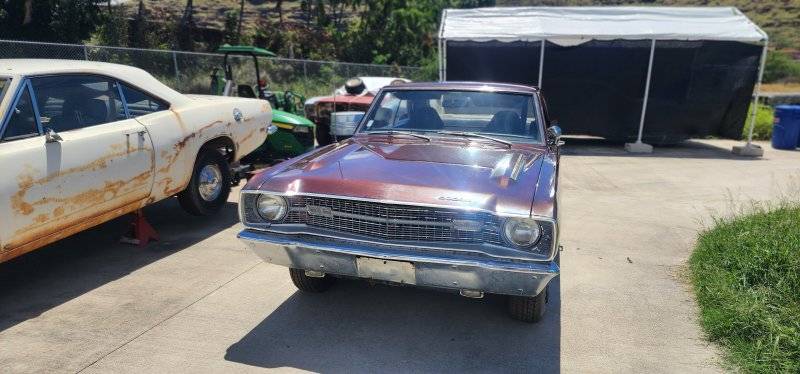

I thought that too when I saw the first pics before talking to him and seeing the car. The engine bay was painted flat black. The car was repainted metallic brown over the T5. The bottom of the trunk lid and door jams show original paint.

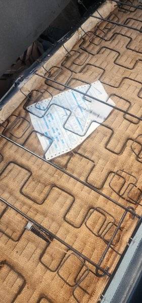

Pulled the back seat. Found the broadcast sheet. In perfect shape.
