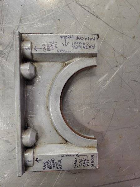

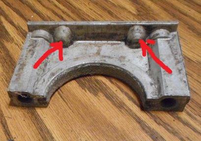

If you use stock retainer grind these nubs a little.View attachment 1421964
With stock bolts you need to grind the point off the bolt so the retainer sits flat in some cases, the retainer is thin there so I do the bolts. The retainer can also hit the rear main cap before the ends of the seal line up causing a leak, you may need to machine the cap or seal retainer, where the little squiggles are. Also be sure your rear main cap is pushed forward so the relief machined in the rear is lined up.

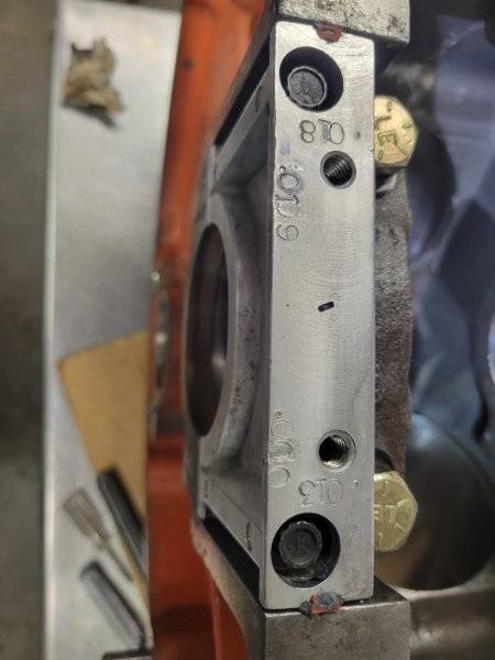

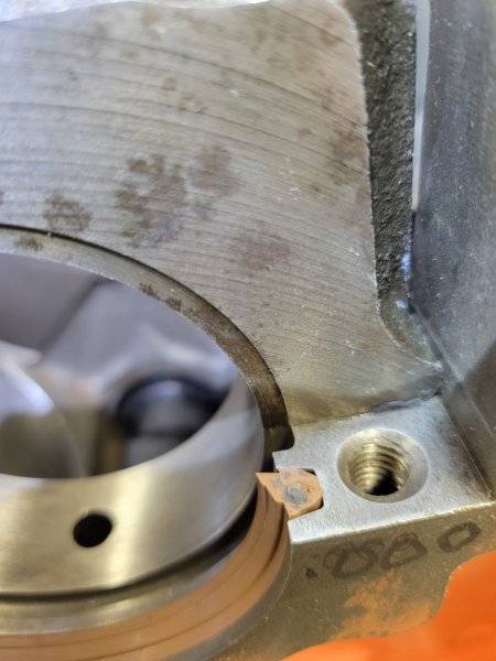

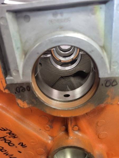

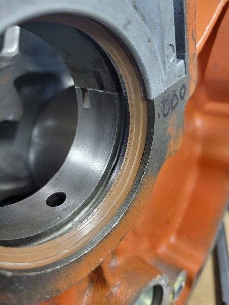

You also need to line up the seal ends perfectly, then stamp the retainer sowhen the engine is in the car you know where to put the retainer. In this blocks case it need to be .020 further forward on the passenger side, and offset .005 to the drivers side. Doing it in car will be very difficult, that's why rope seals work so well. Even with everything I do, it can still leak as the block can be machined wrong and the seal does not quite touch the crank, no way to see that in the car. I always set the engine on its back and pour oil in and test for leaks.
I have heard of others mentioning grinding these spots on the retainer. My question though is why would that be necessary since the factory never had an issue there in the first place? Stock retainer, bolts, and block.
Because the factory used a rope seal, if the retainer was out of alignment .020 because of the bolt it did not matter, with a lip seal. 020 will be a leak 100% of the time. Some blocks have major crank to seal misalignment, as in the seal will not touch the crank, so you epoxy some steel in the groove on that side, or some other hack, or use a rope.

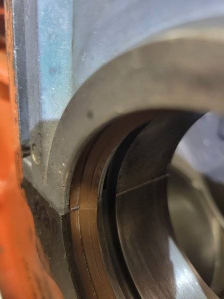

Just fixed another buddy’s rear main seal, motor in car. He’s tried it twice already and the last time time a fast fish 1 piece seal. I guessed it was leaking like mine. In between the seal and upper part of the block. We put a rope seal in it and it quit leaking. We still used the Fastfish retainer.

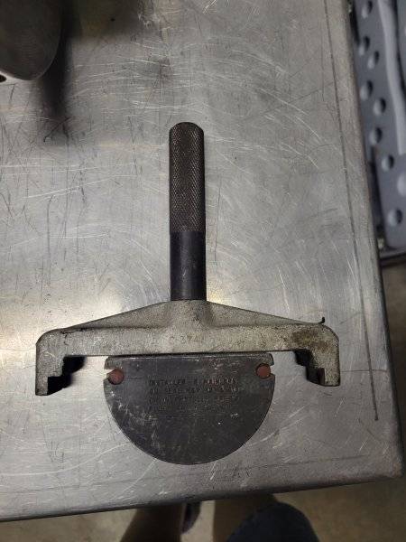

I think in car a rope is your best bet, pic of the install tool.
