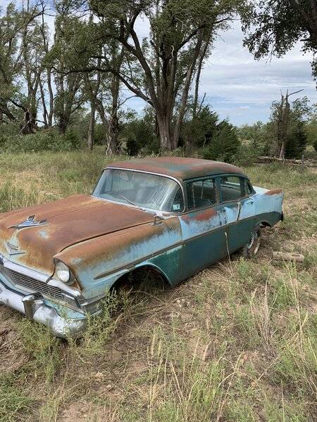

I’m dragging this ole 56 out. It belonged to my grandfather. 265 and a power glide. It’s been sitting since 72. Wish me luck. I have absolutely no Chevy parts laying around. Good thing they cheap.
Hopefully all the trim is there because 56's have lots of it and most of it is one year only.

It looks complete. I would go 100% original. Things like an aftermarket intake/carb won't add that much. There are so few around that are done original.
If it has vacuum wipers, the electric motor bolts right on with no mods. 70's front discs are pretty much bolt on. I might have a hubcap or two you can have for shipping. Have you found the fuel filler neck yet?
Just keep in mind that a 4 door sedan is not worth very much and you'll be in that car way backwards, However parts are relatively cheap and readily available for that.
If you leave it in patina and just get it driveable you'll be ok. That car mostly restored is only worth about $16000, a 2 door triple that.

That's a 210 model so not quite as much side trim. Floor supports, floor pans, tail pan, inner and outer rockers and the dog legs on 4 doors are probably the most common rust problem areas (not counting the inevitable headlight caps, spare tire well and the inner rear wheel wells, which are tougher to repair). Repair parts readily available and pretty reasonable. May have to look a while to find anyone willing to rebuild a cast iron power glide. I remember that being a problem 20+ years ago.
Guys are converting them to 2 doors now. Hoods seem to be hard to find and many of them have a good sized dip in the center, or have been sprung bad from forcing against rusted hinges.

Good luck with the project! You'll enjoy it. That two tone color combo is really sharp. The 56 two tone capabilities is what attracted me to that year more than 55 or 57.

My plan is 350/350. Disc brakes. Fix no rust. No body damage. Just clean it up and clear it or linseed oil. My only concern is frame rot from setting on the ground. But it had blocks under it in front. Supposedly reverse went out so it was parked. That’s what I remember him telling me. Tho he’s been gone for over 20 years now.
