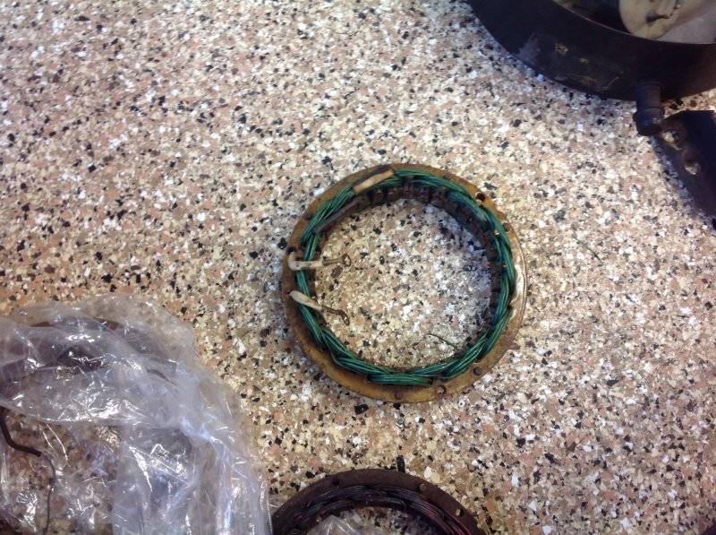

Any idea what these are for?

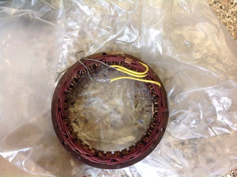

You'd have to know the specs. Different field windings for different amperage alternators. I've soldered together a few. Any part #'s or i.d.?
IMO....
It looks like a stator windings for a 42 amp round back alternator as the diode connections are for the pressed in diode arrangement. The square back alternators use a different diode arrangement that are connected differently. USUALLY the higher amperage alternators use different color varnish (green) and different size wires (smaller AWG number but larger wire size). These COULD BE used in square back units but would need the diode connections mofified to suit. You could also compare RESISTANCE (ohms) of the windings to each leg or to the common connection (a WYE or Y configuration).
