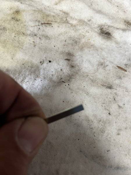

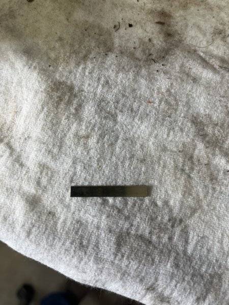

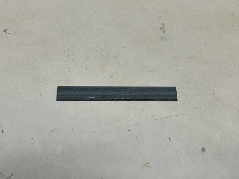

Changing to new signal switch on 69 b body….as im installing, this piece hits the floor? I have no idea where it came from or where it goes?
Is it part of the switch?

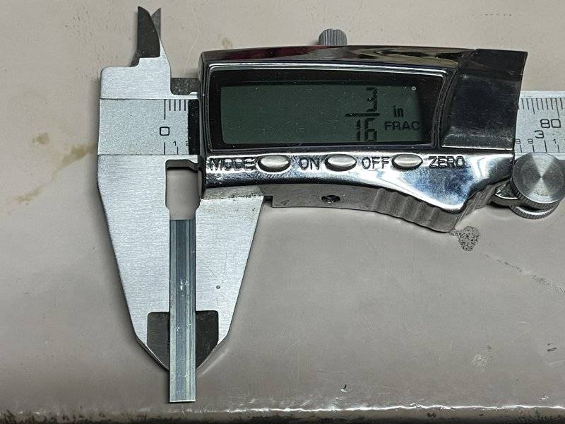

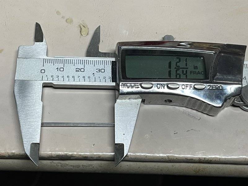

Very thin metal, 1 1/4 long x 3/16 wide?
It may not even be from the switch!
its a type of tension spring. look at your removed switch to locate its placement
Ive been searching for a schematic or blowup pic of a signal switch to see where this piece may go, no luck finding a picture

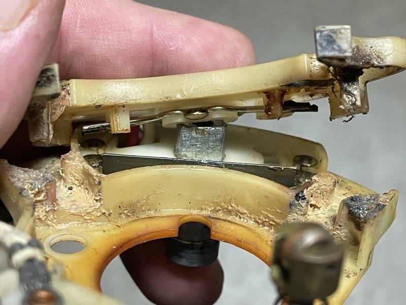

Column shift car?? If so it could be from the ignition key switch.
Wow!!! Tough crowd!!! (And funny, too!) :drinks:

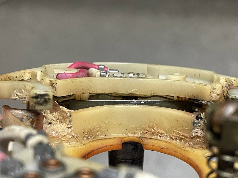

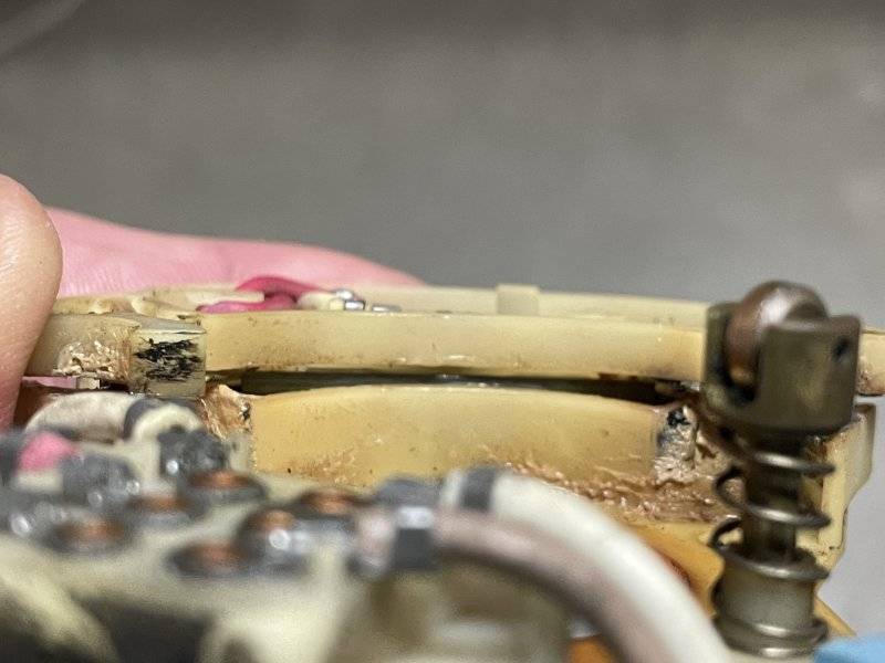

The ring on the crush can initial unlocks a left or right turn position. The piece koosh asked about is a return spring to center the cam from a left or right turn.
Here are some pictures...
Here are some pictures...View attachment 1751506View attachment 1751507View attachment 1751508View attachment 1751509View attachment 1751510View attachment 1751511
Wow!!!! and the switch manufacturer said it was not part of the switch i purchased!!!! Now that everything is back together, wonder if i need it. My aftermarket wheel adapter has no provision for turn canceling
