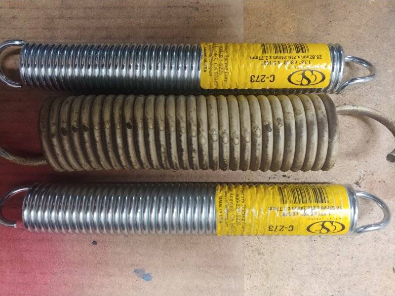

Fiberglass hoods require lighter springs. The CSC C-273 springs are commonly used by B Body members.
