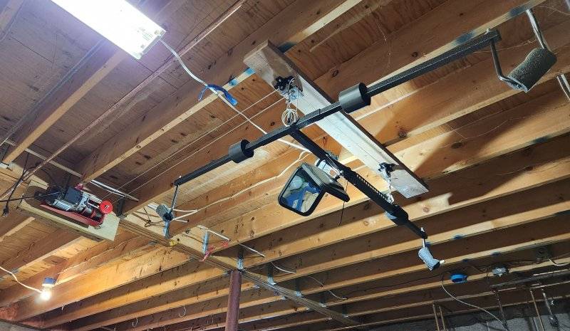

I have one of these Jeep hardtop winch things. It would be relatively easy to make some brackets to adapt to an A12 hood. And if I happen to come across one, I will use it.
Jeep hardtop are several hundred pounds, so I don't see an issue with weight.

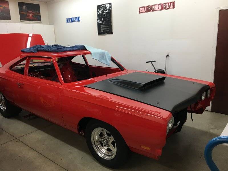

A quilt on the roof of the car was always positioned first to give a landing spot for the hood once removed.

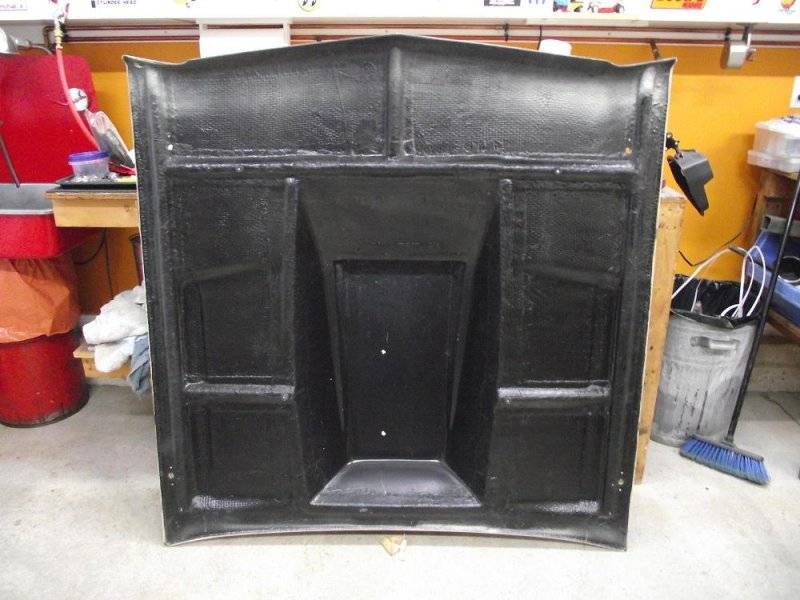

This is a typical case of overthinking the problem. The A12 hoods - even repops - are a manageable weight. And with four pins you really have to be a moron to cause any damage putting it on or off - well maybe if you dropped it when you were halfway over the car, but that's where the "moron" part applies!
First two are my old "lift off" hood. About twice the weight or more of an A12. No issues lifting it on and off over the years of use. Last two are the current "hinged" A12 repop. Considerably lighter - still no issues. It hasn't been permanently attached to the hinges yet as the car is still in the reassembly stages. The car is one and the same.
Nice rides. Thanks. The oem a12 hood weighs about 30ish lbs?
