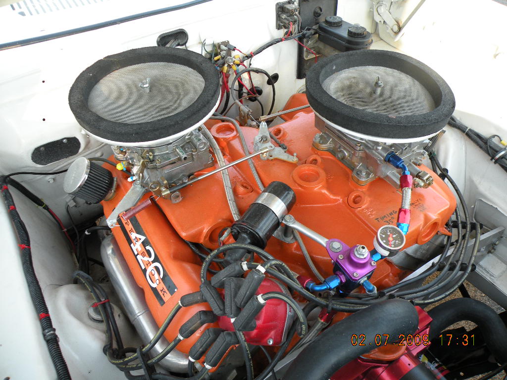

get yourself, 3m weather adhesive the yellow goop, take off your old gasket, brake clean the inside. wait till it drys then put a bead of 3m weather adhesive around the perimeter of the valve cover gasket. wait 5-6 minutes till it gets a little tacky and then lay the gasket along the inside of the valve cover. keep it in place for a good 24 hours and then lay it on the max wedge head. if you need to put studs in the holes to kjeep it in place by all means do it.
obtw do your valve covers have the provision for the tabs to hold the valve cover in place or no tabs? just curious.
