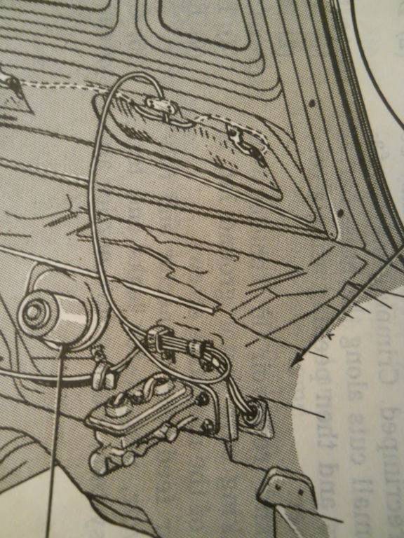

I was looking for a hole that goes into the cowl itself.
Trying to figure how the hoses go to the little hoses on the wiper arm nozzels from there.

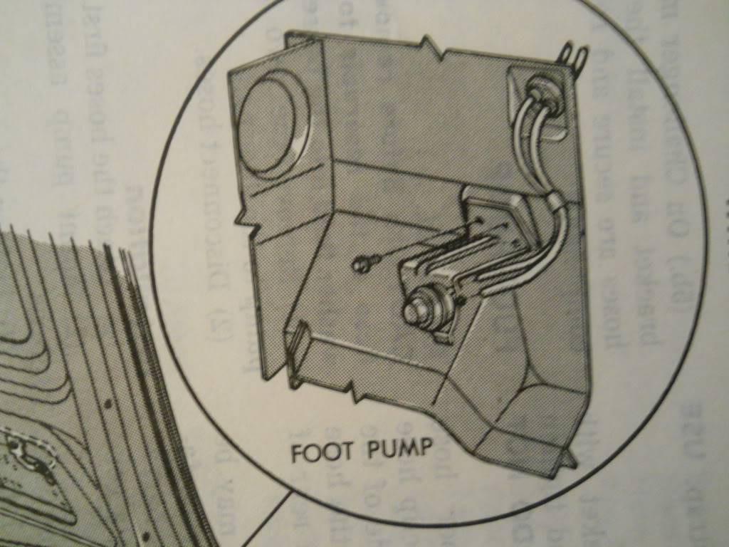

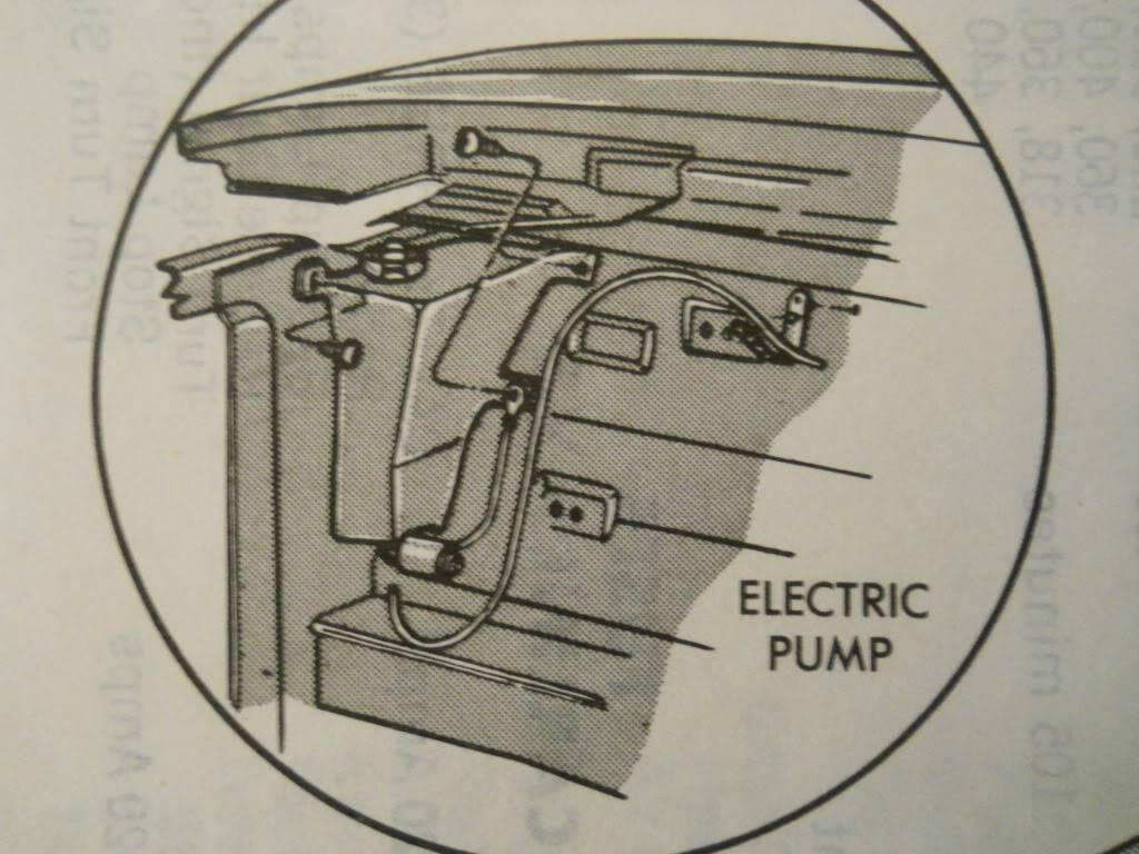

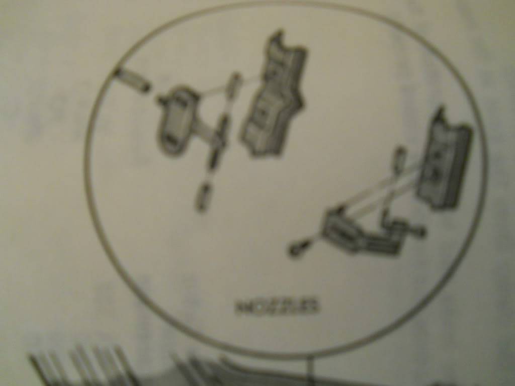

Now that my eyes are functioning better, I retook the picture(s) of the key componets.
It appears that if you have the manual washers, the hoses go thru the firewall to the pump and back out.
The electric version does not go thru the firewall.
Firewall
Bottle
Foot pump
Squirters
