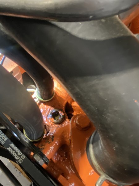

socket extention

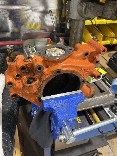

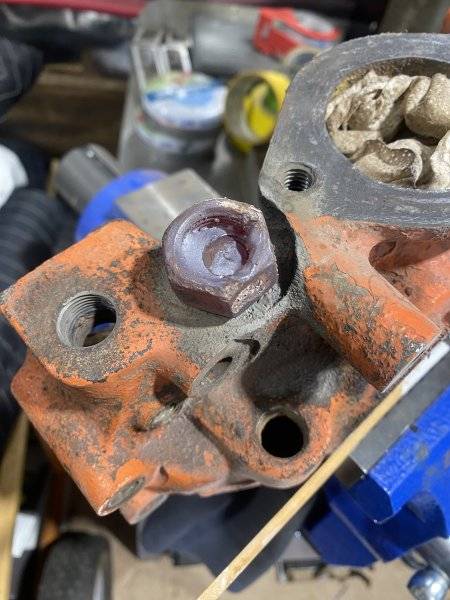

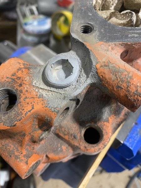

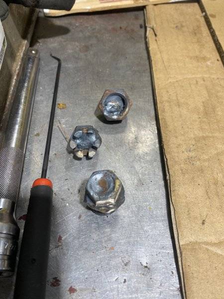

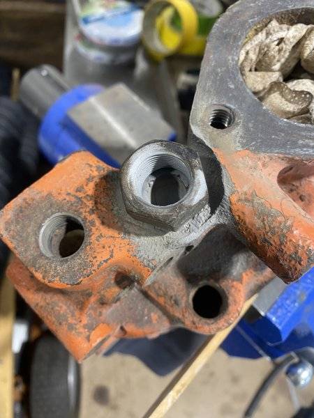

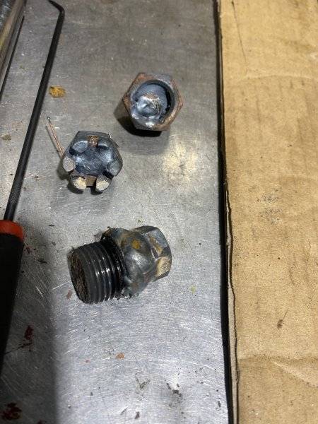

Inquiring minds would like to know….what worked here to get it out? I see you undoubtably used heat, but please walk us through what worked and what didn’t.After multiple fails I finally got it
You were worried about discoloring the paint? Really?Decided to take advice and work smarter not harder. Lets this sucker out of here, gives me the opportunity to get out the rotted heater hose nipples also.
Yes , I know what I’m like. I had just refinished the front and top of engine. Afterwards I decided I wanted a gauge, so I needed to remove that factory plug. So I ended up removing it all and refinished to better than before. Makes a difference to me. Just waiting on a nos sending unit for the factory gauge then I’m done.You were worried about discoloring the paint? Really?
