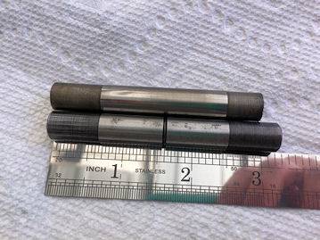

What is the OAL of a good unworn one?
3.220" when new. The used original that beanhead sent me is 3.215. With is plenty good.

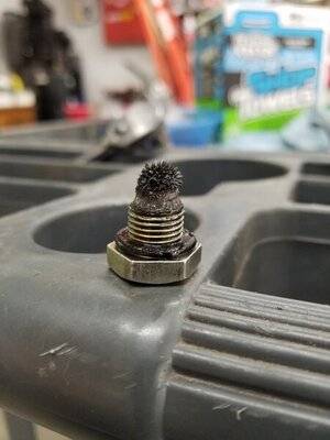

Don't trust anything but Mopar used/NOS. Got a few NOS from McCannix awhile back. Had to replace one installed by engine rebuilder (local Mopar race shop) for daughter's 69 Charger. Don't know what they put in there but it wore about 1/4" in 300mi. Did a couple oil changes and hoped oil filter got the shavings. Has run fine since..with an NOS fuel pump pushrod.
