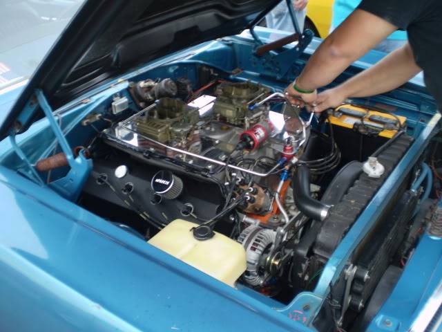

Anybody running one of the Mopar Performance Hemi Crossram manifolds in a 66-70 B-body? If so I would love to see some pics of your install and what hood you are running.
my buddy runs one in a 68 coronet, has a six pack hood. i don't think he has room for air cleaners.
If your buddy is willing to snap me a couple pics and take a couple measurements I would be forever grateful.
My two areas of concern are the passenger side firewall clearance around the manifold and hood clearance.
I am planning on running an RO style scoop and fully expect the air cleaners to be up in the scoop. A picture looking through his hood scoop when the hood is closed would be helpful, as would knowing the approximate location of the carbs in relation to the topside of the hood.
My second area of concern, the firewall, is due to the fact that my car is a factory A/C car and the fittings for lines seem ideally placed to cause interference with the manifold.
Lastly, is he running conversion mounts or a hemi K-member?
