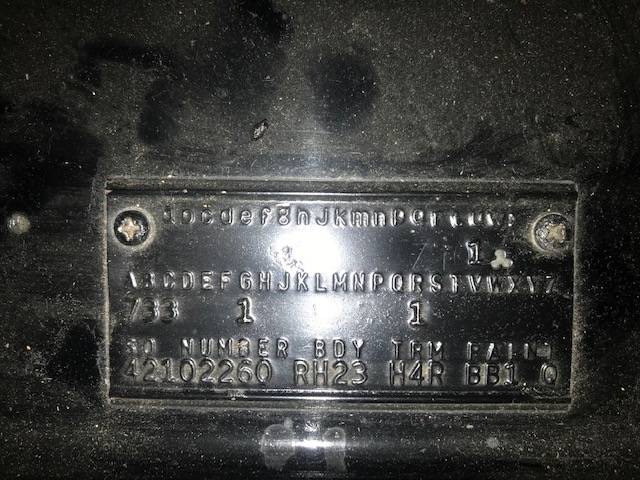

Anyone care to decode this fender tag?

I know most of them but look at the hand stamp under the Q & P on top line. Looks like Z10. Also, what is the punched club mean?

Nice 66 Hemi 4-speed Belvedere. I have no idea on the extra stamps or why some tags have some kind of punched symbols. I really don't believe that Z1o is factory.

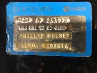

OK thanks !!! What about the Certicard T3 & SG
T3 = Transmission 3 = manual transmission as opposed to T5 = automatic transmission. It's the same thing as indicated by C/3 on the fender tag.
SG= Sure Grip as opposed to SA= Standard Axle.
