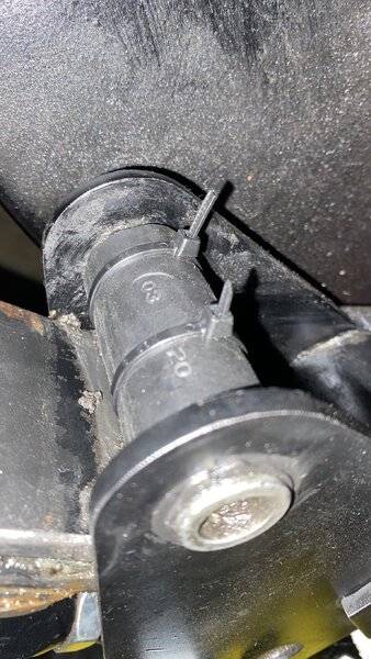

Yes , you mean if you not drive the car “strong „ You will hear it with a bang , but if you drive it hard each gear to 4000 or more the bang will go more to silent , right . first I try the rubber around the sleeve for street driving , because on my system I have the bang only on the passenger side..,, if the rubber not change the Big Bang I will install a Camera who shows me what’s going up with my rear axle and the leaf springs if I in normal street drive mode

Done ! No more hard loud bang ...
I take the pre load out of the cal Tracs again and bring it as much as it possible clearance between the bolt from the cal tracs and the leaf springs.
After I wrapped sone fuel hose around the cal trac bolt and fix the fuel line rubber with some zip ties . Now because the fuel rubber installed I nearly contact with the rubber , like no play in it but also not real pre load . first test drive shows me the Big Bang sound goes more like a dull sound than before but still a noticeable bang if I shift between 2-3 gear with low RPM’s .
