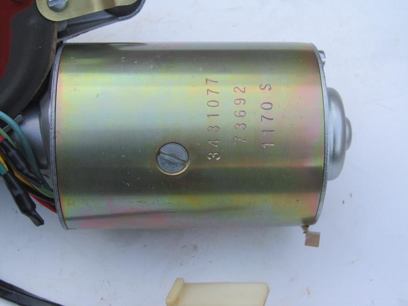

Anyone else restoring their wiper motor?

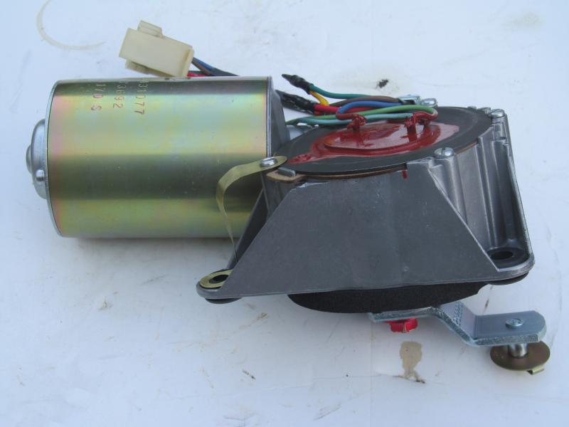

Thanks, it is always a chore to DE-CHEVY a mopar! the last owner had sprayed everything in the engine bay black, typical! lol still scraping black paint off the wires at the bulk head, in the mean time trying to re do everything else.
That link shows the testing method that works if all your parts are good.
Looks great "Bigman"
Yup, that is a swell detail job!
An often "overlooked" item in the engine compartment!
Looks awsome! Does any company make restored 3 speed wiper motors, i tried passion for mopars for the last week but no answer or reply back. Thanks
I have a few motors but im not sure if they are correct to the car. I putting a 3 speed wiper motor on my 68 charger. Im not sure if they ever came with 3 speeds from the factory. I have the switch and proper linkage but no motor that i know would definatley fit the car. Thanks

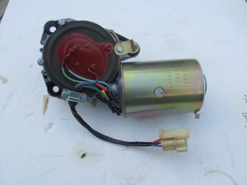

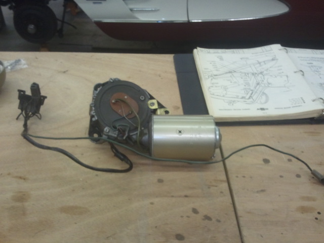

Was having issues with the ark feature again, solved this time I think. I believe I had the housing on wrong and the copper contact bar was not making a good connection, clocked it the right way and got the bar back into position, seems to work now. If anyone needs help let me know.
That one looks fantastic, great work on the resto. it's perfect. I am looking for a year correct one for 1969 B body 2 speed.

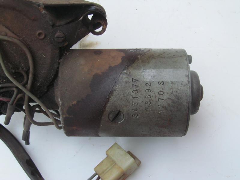

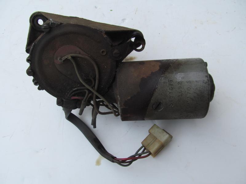

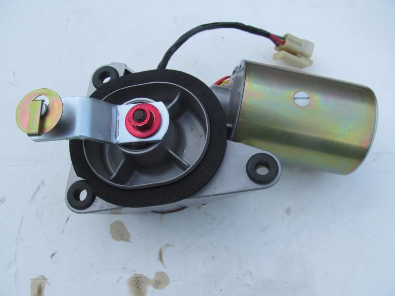

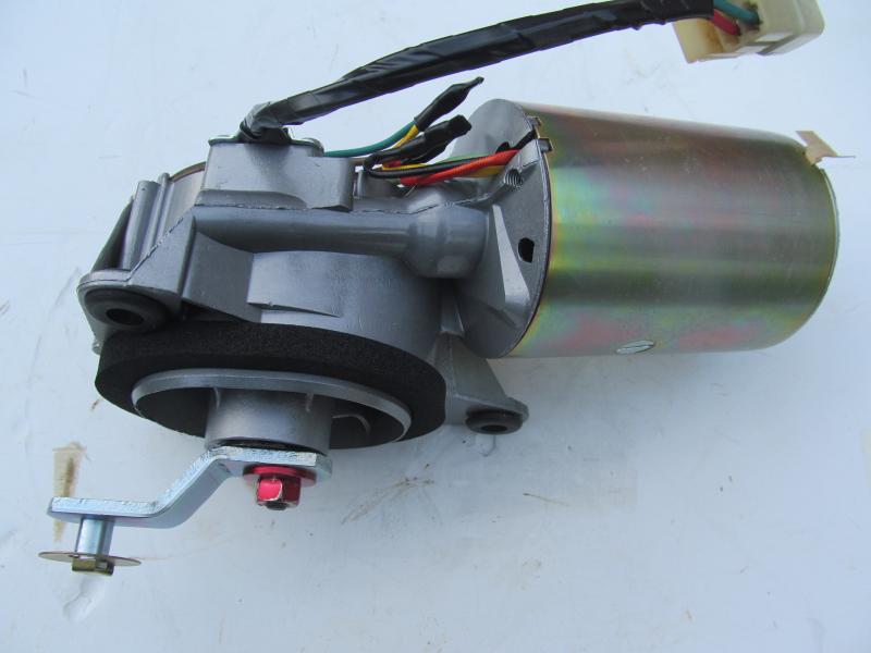

If you need a three speed wiper motor restored, PM me and I will give you the information to a guy in Michigan that restores and rebuilds them for $245.
He has done several for me, I have included photo's of the recent one he restored for me.View attachment 172273View attachment 172274View attachment 172275View attachment 172276View attachment 172277View attachment 172278View attachment 172279

Here is a quick pic of mine. Not as gorgeous as your freshly cad plated one, but good enough for my car.
