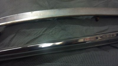

Jestco makes a deanodizing solution that works awesome. Foillow the directions and then steel wool, buff and polish. Turns out great!
