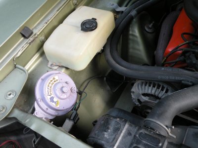

Here ya go on a 1595 mile survivor car.69.5 a12 roadrunner
