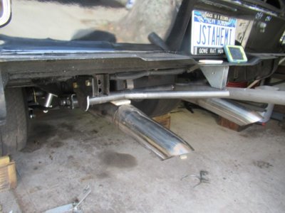

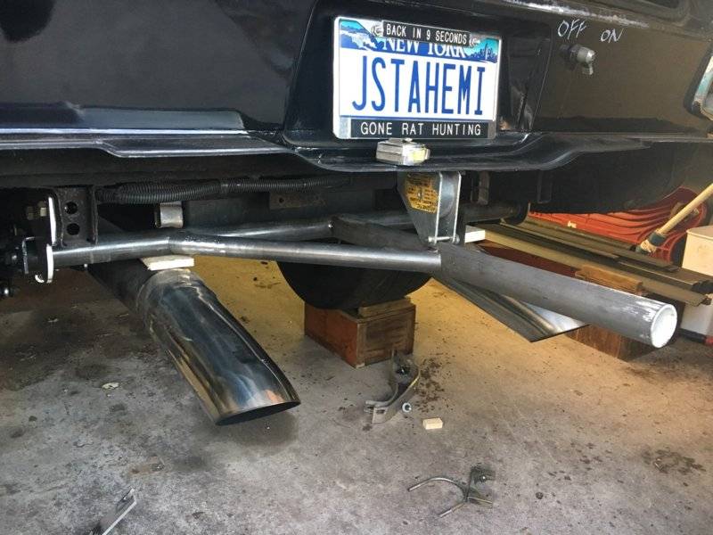

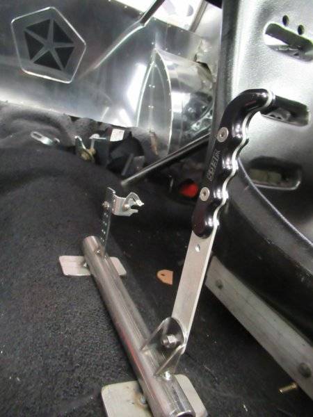

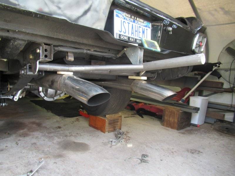

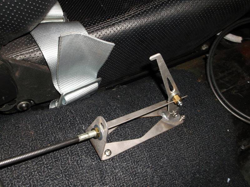

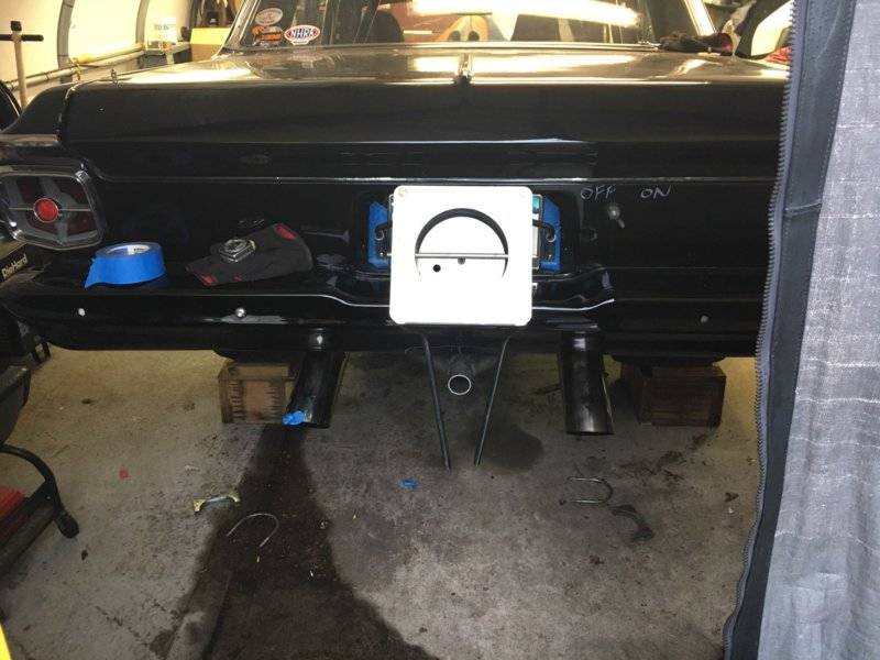

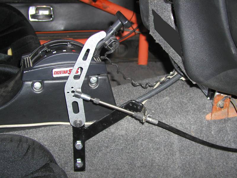

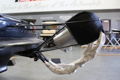

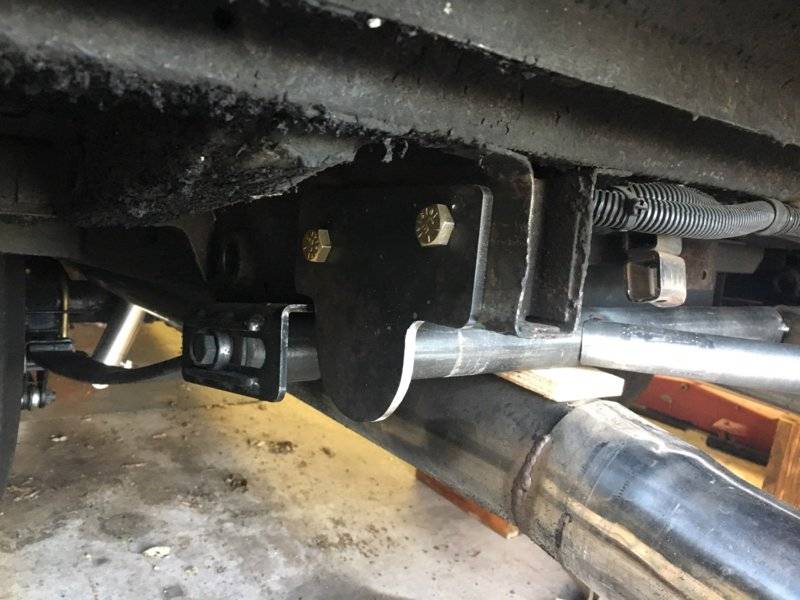

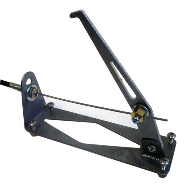

I want to be able to remove the chute with a slider and a pin.I found one picture of a removable launcher and I didn't like the way it looked , the pack looked like it was 3 feet behind the car! Also will mount the release lever on the floor.
Anyone have pictures of removable launcher,I went Stroud FWIW:)

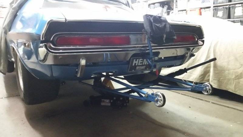

Mine is not a launcher but it is removable. My favorite part of my car even though you can hardly see it once the bag was installed.
I took that pic for my collection!! Best looking bag mount I have seen!

Thanks. See can't see much now unless looking down the trunk line from the front.

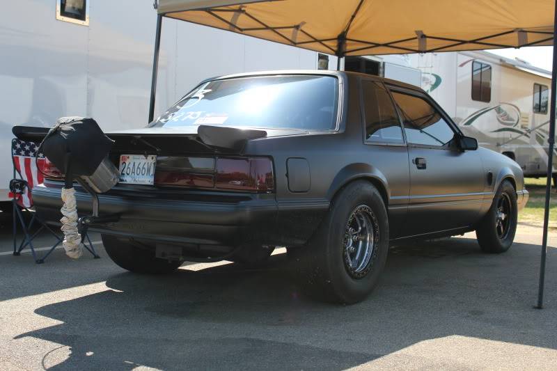

Looks good on the Mustang but I would think with a launcher chute & that angle it may lift the car & get loose some at times once deployed. Angle does not need to be that drastic.
