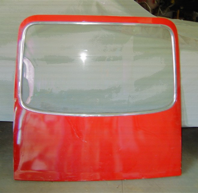

Early 70's Vega.
I think it was a chevy monza hatchback for the superbird and vega for the daytona.
For some reason it stuck in my mind that Chrysler was using 4 dr back windows for the bird. Is that just an old man's mind playing tricks? If not, you could just grab a sction of roof as well, weld it in, and that kills several birds with one stone. No pun intended
no its a totally different shape and look then anything else
the cuda idea works ok but its still way smaller
but the vega stuff is very close for a daytona and works great examples below

I remember someone telling me they used one of the Chevy vega rear glasses and it was verry close. I dont remember witch one but worth a try. This may be for Daytona as well.

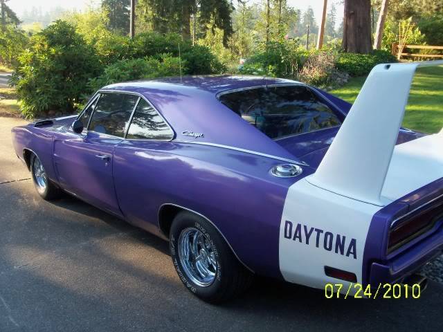

Is that OE charger glass or Vega glass?
One day, I would like to build a Clone. I think OE charger glass looks cool, so...
thats OE charger if it had a vega hatch it would look more like a fast back not sunken in like stock in that picture .

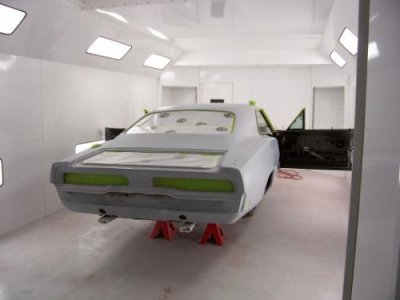

here is what intailed to install a vega hatch ., you also have to shorten the decklid a daytona deck lid is not very wide to accomidate the fast back styling and clear the wing .
