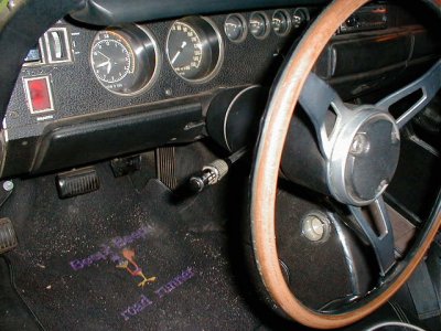

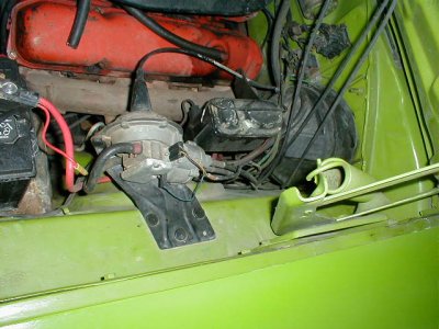

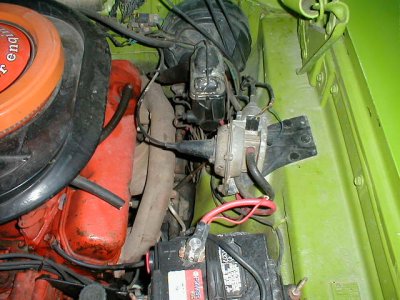

Here's mine on a Roadrunner.
Thank You Jaws, I apprecaite your pix, this helps me know how to rig mine up, best wishes CD Boise ID
