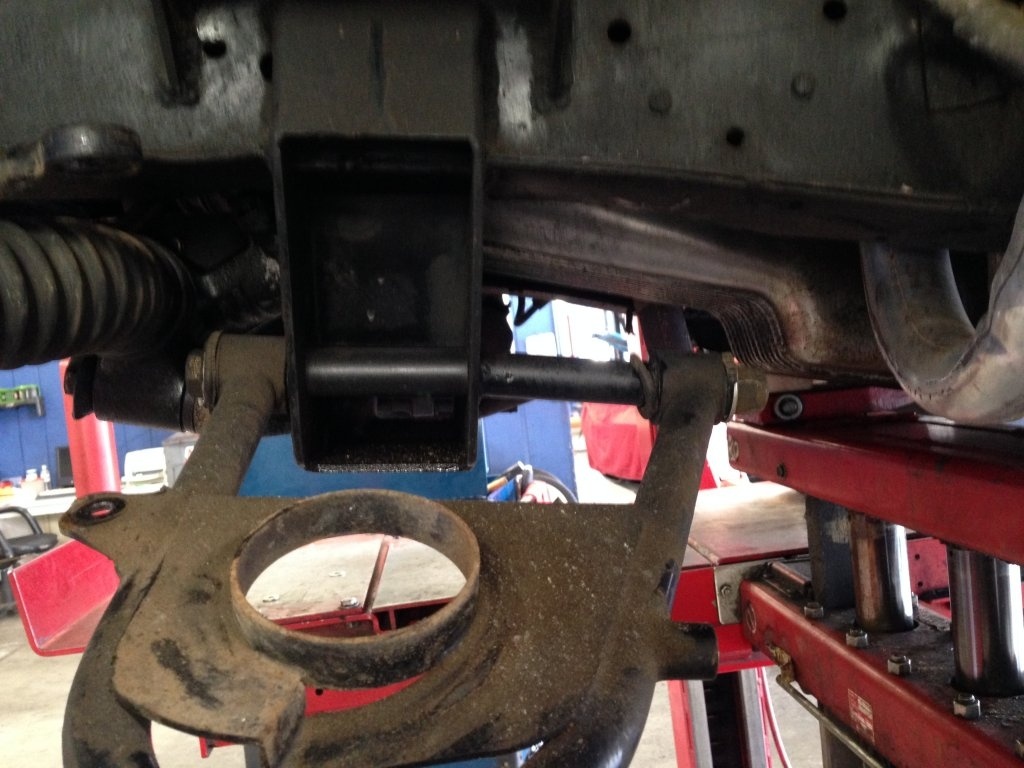

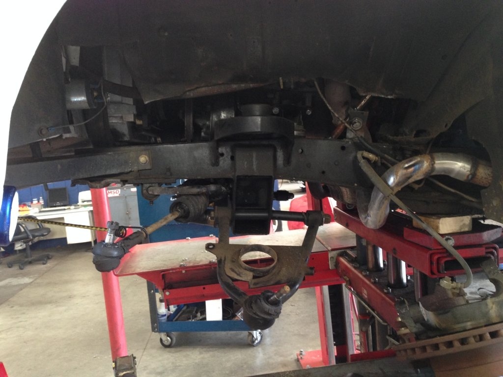

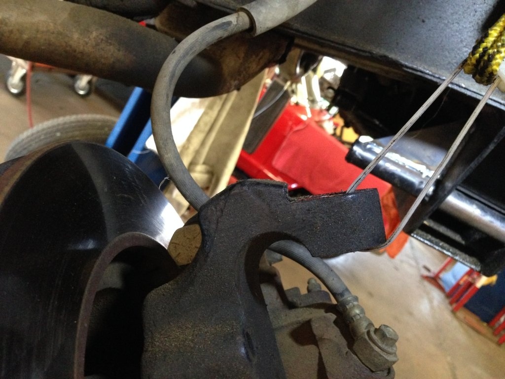

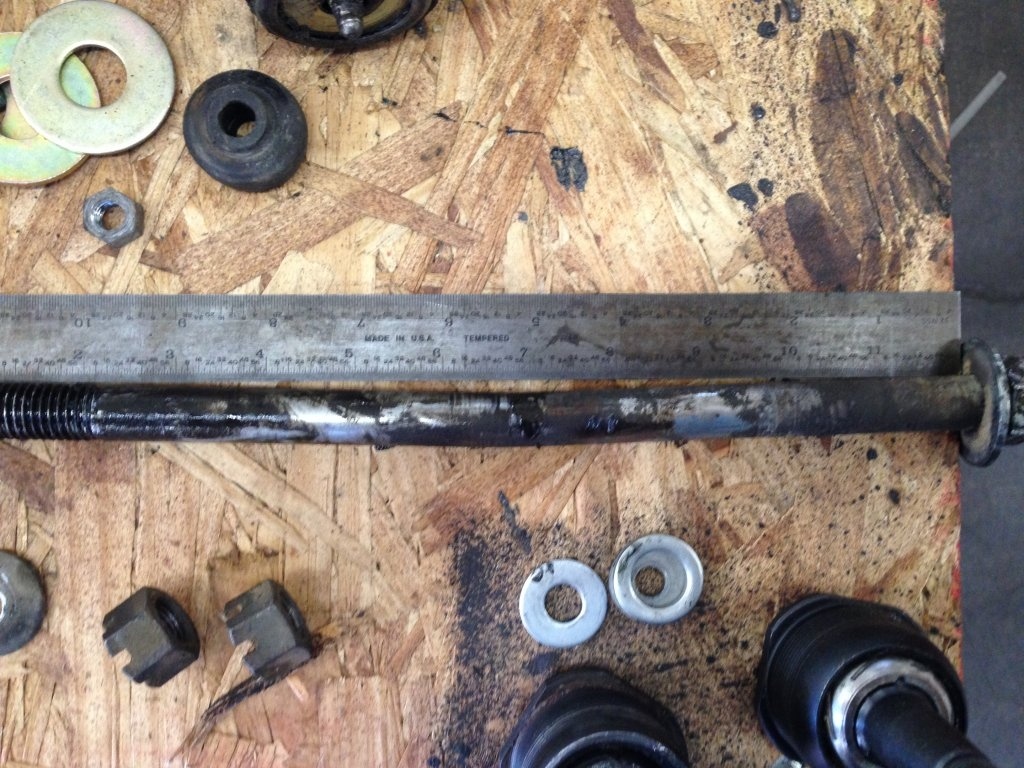

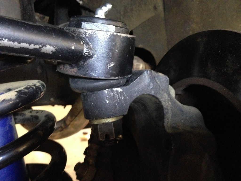

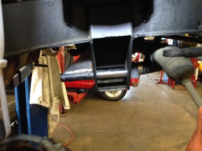

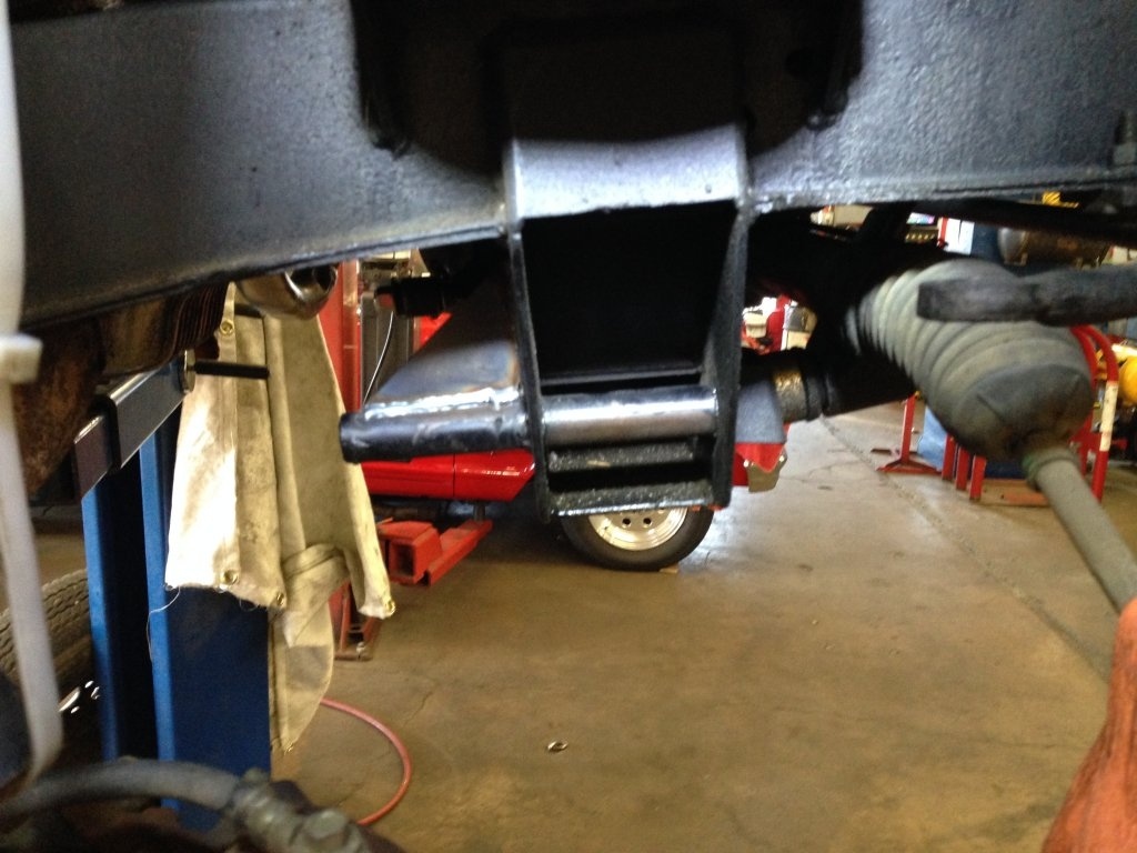

Here is some interesting information for you to digest on Mustang II stuff that I recently experienced at my 8-5 job. The car is a shoebox 52 Chevy that has the Stang based components on it like what you see advertised from various companies. He brought it by recently for us to inspect and we found it needed ball joints, arm bushings, tie rods and rack mounts. Supposedly this stuff was replaced 2k or so before the current owner bought the car and has since put less than 5 k on it. The components were toast. Probably write that off to poor quality stuff. Ok. Get the car in and start disassembling the lh side. After I clear components out of the way, I see that the lower control arm mounting bosses don't look kosher. They are bent. Had to knock the long bolt out, which was fun, and found it was bent almost 1/2". The mount bosses only have a horizontal gusset welded to them, no vertical. Ok, make a couple of them so each side can have one. Place a screw jack under the tube so it gets squared up and I weld the gusset on. Go to start adding the arms back on after joint and bushing replacement and run into my next hicup. The upper control arm ball joint boss is hitting the spindle and I can't swivel the spindle if I tighten the castle nuts. Not cool. Turns out that the ball joint stud between old and new are different as old ones had a longer stud with the taper starting farther away from the main joint which in turn would give more clearance between arm and spindle. Granted at this time the suspension is at full droop but I could see that there was an interference problem from before. What I elected to do was blend back the step thats machined for the joint to fit through so there would be no more clash and the owner and us would not have to chase down special ball joints. Get the left side done, hop over to the right side and see its a repeat of the left especially the arm mount. Go to remove the lower long bolt and see the boss flexing up and down. I decide to get it squared up and weld the gusset on while its still together. When I go to remove the bolt, this is after the gusset is welded on, the boss is still flexing up and down as the bent bolt is turning. The crossmember is flopping around in that area too. Can you say "lack of structural ridgidity"??? These arms, lower, should be mounted in a double shear with short lower bolts like you see on a production vehicle. Instead the bolts are not supported very well and bend. When would they end up breaking from lack of proper support? The weight of this car is probably lose to the muscle cars which is most likely still to heavy for a Stang suspension to safely support. Rods, roadsters etc maybe but I would still redo that lower arm mounting. Anything else, for me, not only no but hell no.
IMG_1883.JPG IMG_1884.JPG IMG_1885.JPG IMG_1886.JPG IMG_1887.JPG IMG_1881.JPG IMG_1882.JPG
You will find the OEM Mopar suspension is hard to beat when considering price and quality of ride.
As mentioned, when in new condition, it will last 100,000 miles with little fanfare....
Oe may not be the trick of the month but its proven. I think if you are going to do a switch out, you should go with the full frame units that use Vette, cough cough, based suspension or circle track/NASCAR stuff. Those are way better mounted and built than the Stang stuff. In case anyone wonders, the owner of the car did not learn how to drive at the Braile institute. He babies that thing. Also, watch who you source your replacement ball joints from The chinese replacements were shorter than the NAPA unit I got to compare with. Shorter overall and shorter on the area where the taper begins on the stud which will affect geometry and who knows what else.
