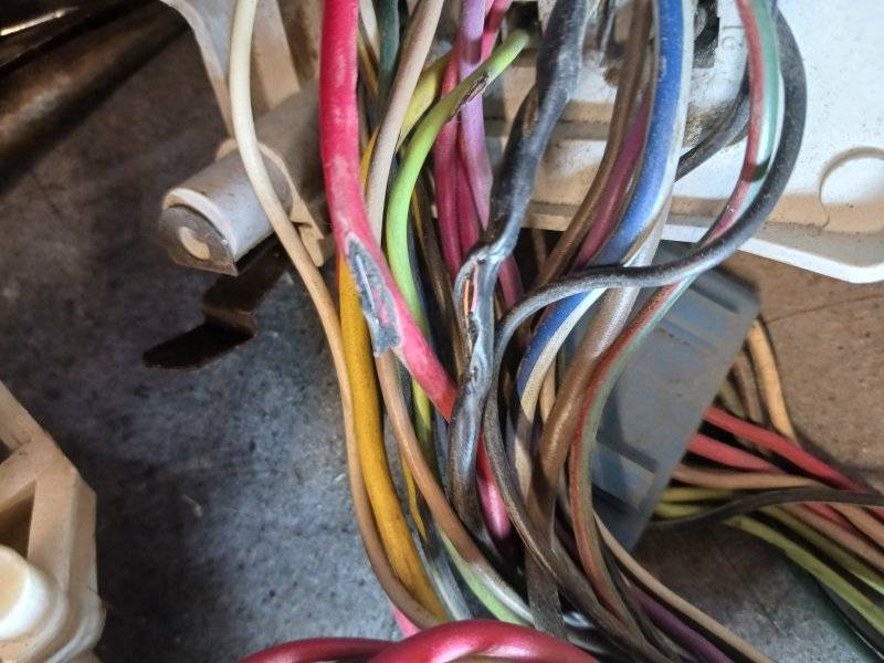

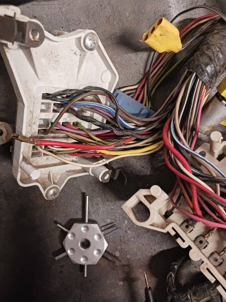

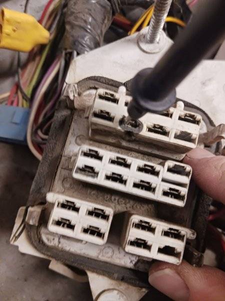

Biggest electrical issues with our old mopars are the bulkhead connectors, they get oxidized making poor, weak connections. Take them apart kleen the contacts, coat with dielectric grease and reinstall...

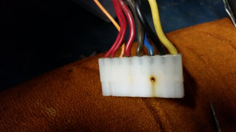

I agree with the bulkhead connections and the steering column plug/wiring. I'm kind of old school. I turn the key on. When I couldn't get a car to crank over, I used a jumper cable from the battery + to the starter cable at starter relay to crank it. If I wasn't getting spark, I put a wire with alligator clips on the end directly from the battery + post to the coil + post and see if it fires and runs. That answers a lot of questions for me. Then, I go from there. As an after thought, I added a few photos of the problems I found on the bulkhead connection box on a 72 Challenger I'm currently working on. If I had not corrected the problem I could have had a dash fire in my shop if I had energized it. Not good. The last photo is of the column electrical plug with a burned spot.

Thanks! This is helpful. I may try to replace the bulkhead connections to avoid potential issues, ive had a few wires burn out previously, along with constantly replacing fuses, lol.
