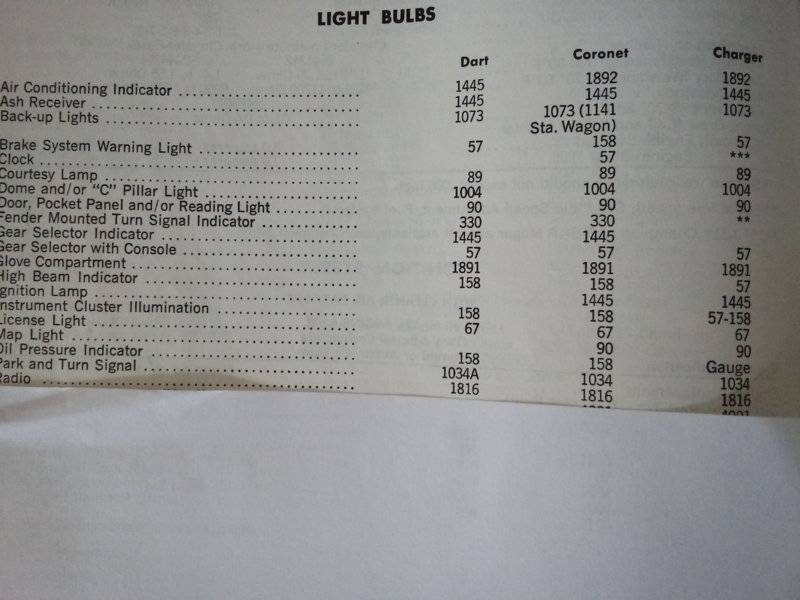

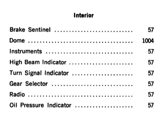

Don't know if they are the same, but I found this list in my Dodge A100 manual....
According to my manual it's 1816.
Yep, 1816. Thank you, the both of you. Appreciate it
