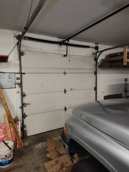

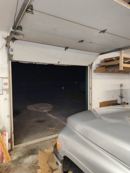

So, my workshop door has a broken spring.
My garage has 4 single-car doors total - built like a bank barn, it has 3 doors on the lower level, and one on the upper level. This upper level is my workshop, and where I park my work truck as well as keep my pro audio equipment. This upper door is the one that has a broken spring.
One of the lower doors broke a spring years ago and I had it replaced. I remember watching the guy do it, and it was some sort of sorcery, black magic type work that involved not amputating fingers or sending wrenches through his own skull while he was removing and replacing the springs.
Has anyone here done their own spring replacements? My doors are "heavy" - they are single car doors, but they are insulated, and they have a veneer/facade on the outside which makes them look like carriage house doors (but adds weight because it's a sheet of 1/4" plywood facing). That tells me "more finger-removing, skull-cracking spring tension"..... I have the spec tag from the last spring replacement (250x2.000x41.00), which I presume is 250 lb rating x 2" coil size x 41" long, and I assume I can order springs from that....but the guy who did my last one appears to have retired, and I can't get anyone to return calls about the job.

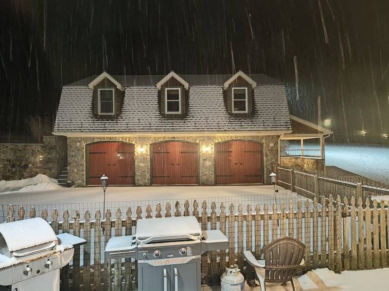

Here's the door in question:
...and the lower level, just because I love my garage...

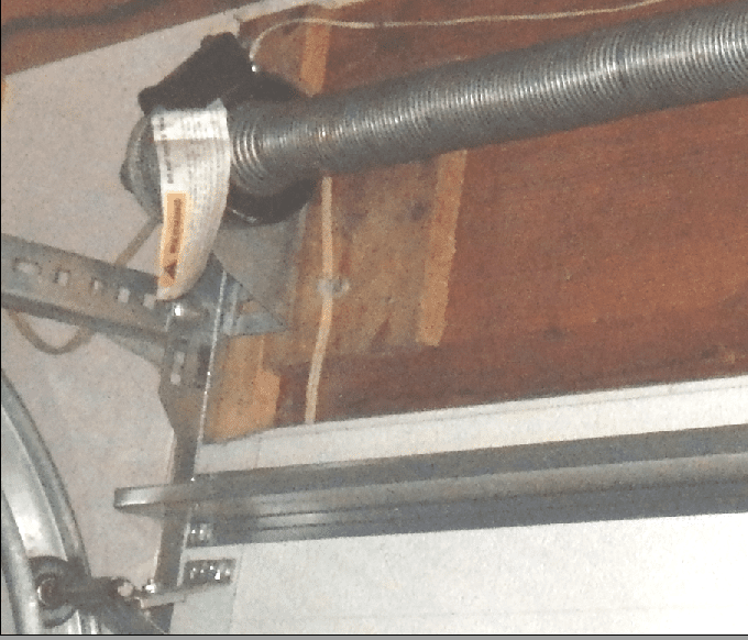

That wasn't bad at all.
Step one, insert rods into new adjuster holes before installing the springs. Make sure they go all the way in. I had one hole with burrs in it, only gave me about 50% depth. No bueno. Little Dremel work...fixed.
I also inserted each rod (I ordered them with the springs) into the cups, and put a tape wrap on each one right at the cup, for a quick "it's all the way in" reference while working. If there was rod showing between the cup and the tape...it ain't in.
Installed the new springs and a new bearing. Reinstalled the cable drums. Turned each spring (25) quarter-turns to tension and tested....nope. Went (30)....close. (33)...perfect. Hooked the power opener to it...ITS ALIVE!!!
Nice and quiet, too. Lubed them with some PB to be safe, and lubed the six springs downstairs too, as maintenance.
This door is now over-sprung. I put on .250x2.00x41" springs. I took out what look like .250x1.75x36"...I ordered based on what was put in downstairs last time. I figure this way, less stress and a longer life (in theory anyway).
Took me all of 90 minutes, start to finish.
