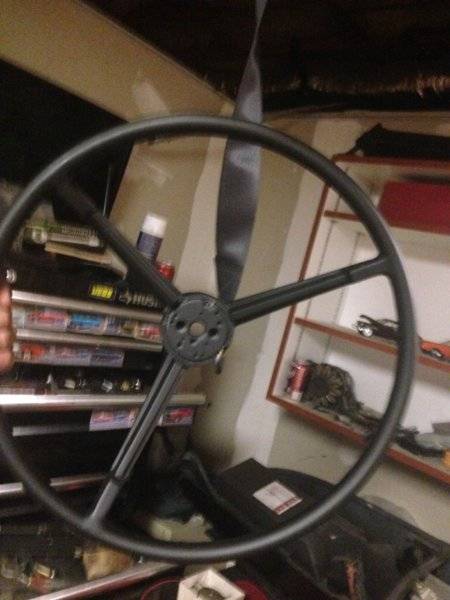

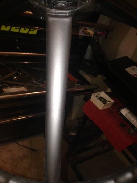

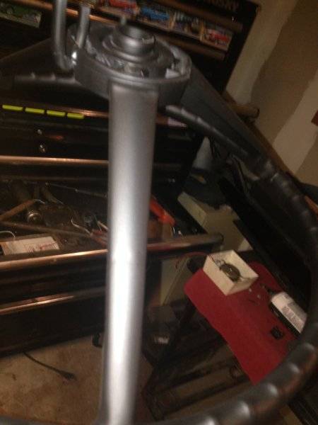

I did the steering wheel in a 1969 roadrunner. Started out with huge cracks in it and missing some chunks around the center. Turned out decent. Used Por brand epoxy putty and lots of sanding..

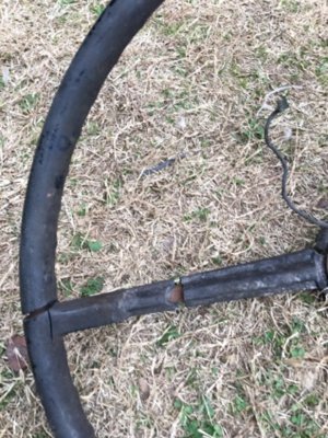

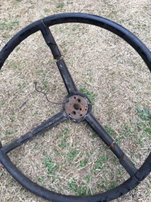

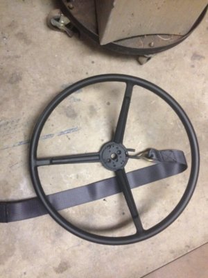

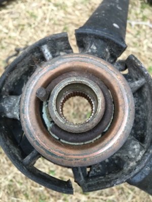

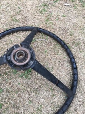

I did my own using JB Weld. Was pretty easy really, it just took a little time. Here's what I started with...
Deep cracks and missing pieces.
Damage was pretty much all the way around the wheel.

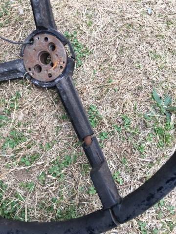

And the back of the wheel.
Filled all the cracks with JB Weld which sands pretty easily I might add.

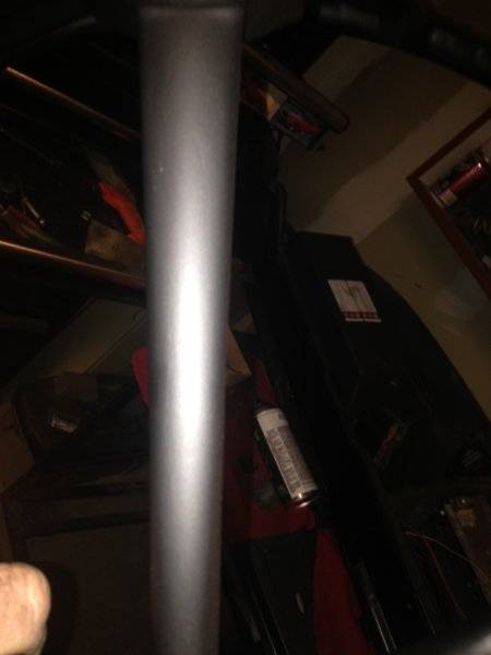

Primed and painted.

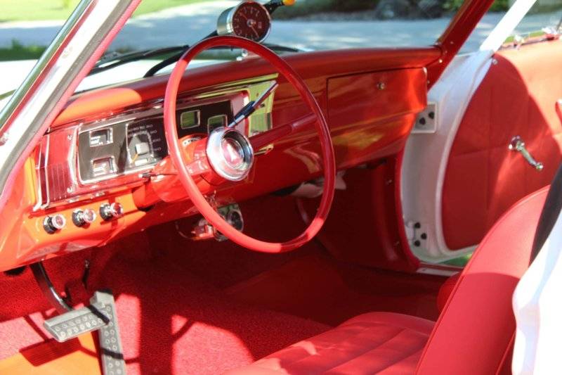

And the finished product. Total cost... under $10.

Yes grooved all of the huge cracks out. Filled with the epoxy putty shaped a little larger than actual size and sanded. Used a dremel to help with finer lines. Mike the guy who owns the roadrunner was ready to buy a repop but I said let me try something before you buy one. He was pleased with the results. Actually was amazed I was able to fix it. 20 bucks later and about 4 hours sanding and I’d say it was successful.

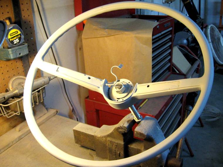

My daughter and I restored the one on our '64 Belvedere using PC-7. Pics here:
https://www.forbbodiesonly.com/moparforum/threads/steering-wheel-restoration.70086/
It came out very nice, but it has developed some cracks over the years since. The car is stored in an unheated building in the cold Wisconsin winters, so that hasn't helped. I sold Charlie Quarters a couple of core wheels. He seems like a really good guy. I've also read good things about the others mentioned here.
