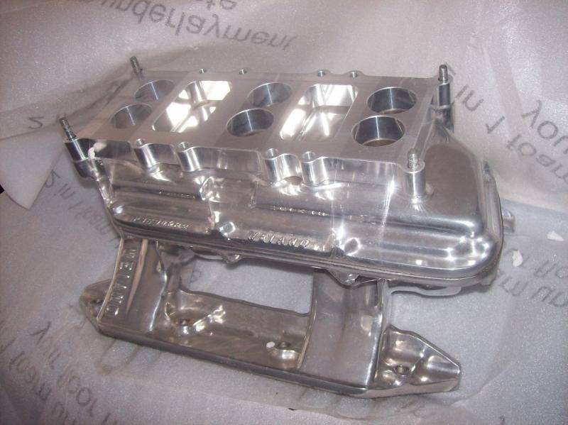

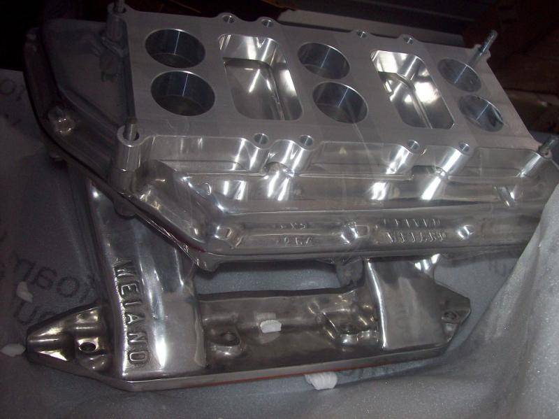

Promax modded my 6bbl, making it run better now, and easier to mod and tune in the future, with my mind on the 541 stroker, and the Weiand P3690982 6bbl CrossFlow "Super Stock" old school intake.

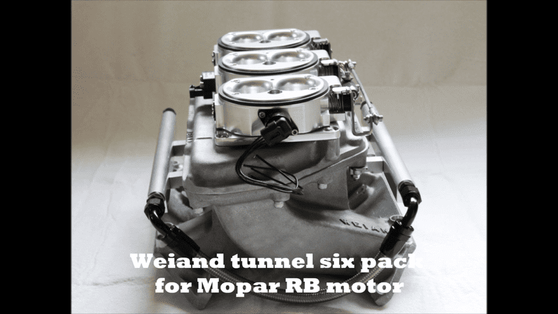

There's a gorgeous "Tripower look alike" TBI/EFI setup, and it really does look like a Tripower, but turn key w/fuel pump, lines, tuning system, etc it's 8 grand!
I have seen a couple of jaw dropping beautiful Weiand 6bbl intakes like mine that are using the F&B Direct Port Injection setup, and ultimately having that intake become a "dry intake" eliminates the common, well known issues it has always had like fuel puddling and uneven distribution, fuel droplets coming out of suspension, etc.
I would LOVE to have it modded to Max Wedge ports, the EFI setup, plenum volume adjusted to work best with MY 541 stroker, and see what that could do, but I have over $1k in Promax parts in my 6bbl. That $1k is nothing compared to what the stroker will cost, including the BME aluminum block, and it's hard to not want to jump in with both feet and have F&B take it to the max, but I'm going to have a hard time getting the money together to finish the 541 build.
